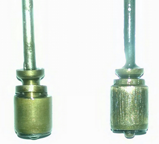

Pic of my unmolested tri carb set up . Breather holes in all the caps . 1/16ā€ ish

Just like mine. Designed to be operated with thumb and forefinger. I can hear the sound they make when you check them just by looking at the picture.

The damper for the HD6 carb is slightly shorter in length than the damper for the HD8. Perhaps someone can chime in on the impact of using a shorter (or longer) damper has on the functioning of the carb.
Lin
The dampers are sized to the carb - if you used an HD6 damper in an HD8 they wouldn't be submerged in oil as well and if you used the HD8 dampers in a HD6 it could prevent the piston from rising fully. BTW, the damper rods are a press fit into the caps - I have triple HD6 now but when I had twin HD8s I used brass caps because at one time I was testing heavier oil and found the rods pushed thru the plastic caps and stuck out the top which led me to pressing them into brass caps, I later went back to lighter oil but kept the brass caps because I prefer the appearance of the brass.
