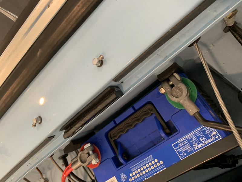

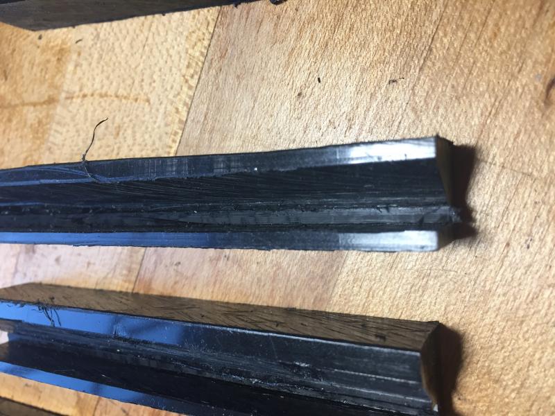

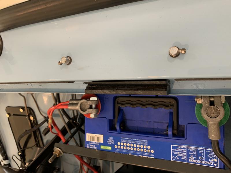

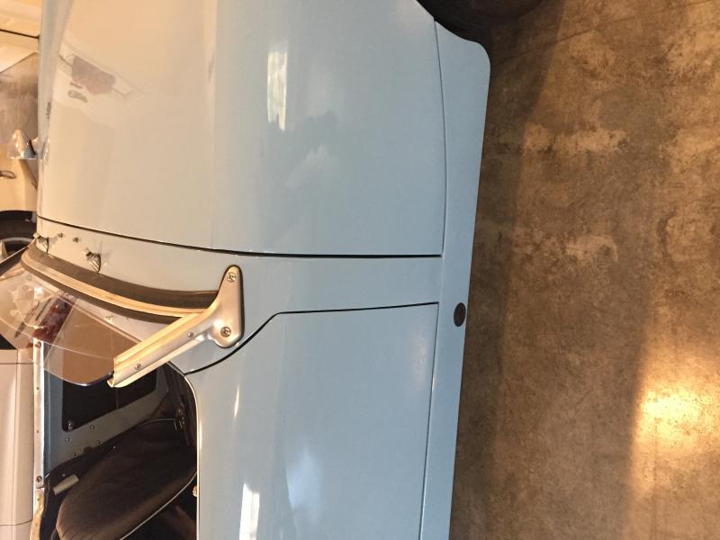

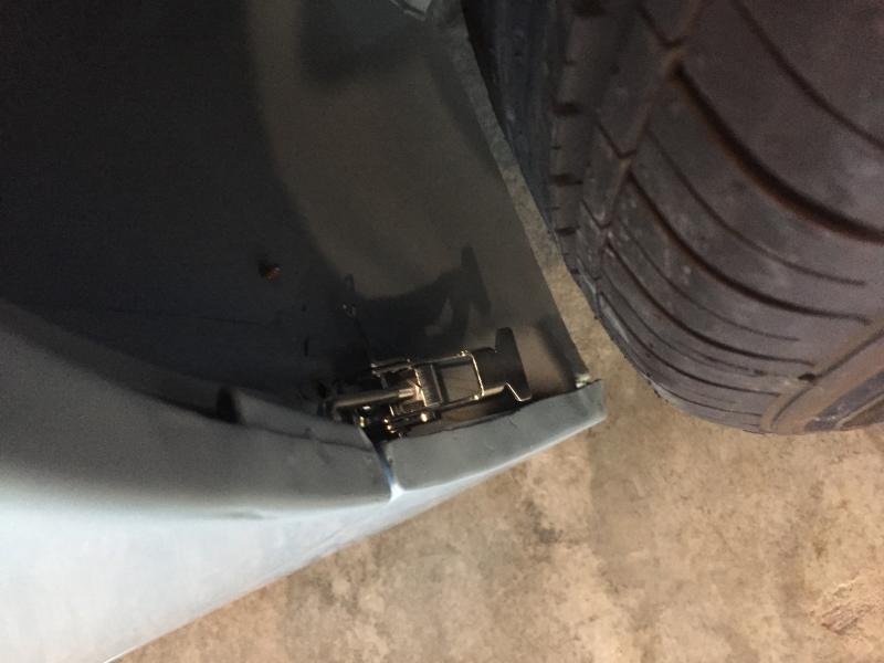

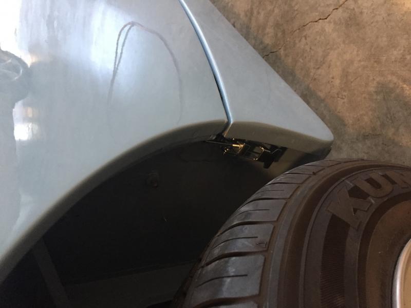

I got so tired of the bonnet shifting in every direction that I finally decided to come up with a cheap solution that’s easy to make. I bent the entire rear lip of the bonnet so it’s at 90*, added some self adhesive rubber weatherstrip along the cowl and installed a HDPE strip with a groove cut in it to position the bonnet. The HDPE has a groove with a 35* entry ā€˜ramp’ to guide the bonnet into the right position every time and it works. I also installed some semi hidden latches in the front wheel well that lock the bonnet into place side to side and keep it there.

That does fit nice and I like those hidden latches.
Rut - is there a part number or description for the HDPE strip? Or did you cut the groove yourself? And any special advice regards sourcing latches that fit behind the wheel. Your public wants to know.... Thanks, Doug
Doug,
I just bought a sheet of HDPE 3/4ā€ thick stock and cut it to length, height and sanded a little off so it would fit in the lip on the cowl. I think I bought a 1’x2’ piece if you want me to mail you some since I have more than I will ever need. The latches can be mounted in the fender well up or down since the hook part swivels and adjusts for length. https://www.ebay.com/itm/SOUTHCO-A1...917194?hash=item48cad9ceca:g:-fkAAOSwqzJc9dYH

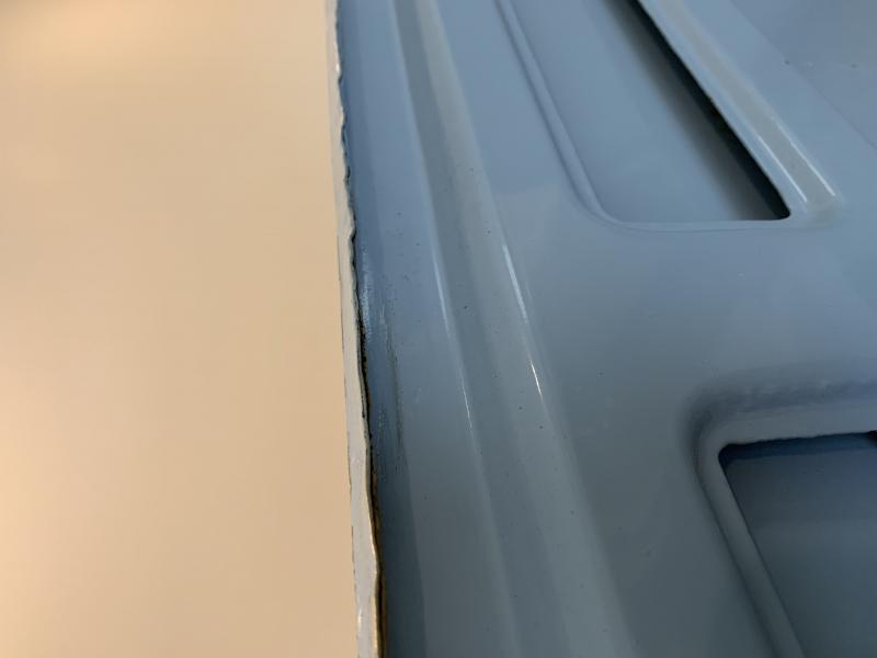

Nice fit on he forward tilt bonnet Rut. Would you have any photos of how you bent the hood and how the HDPE sets in the cowl? Thanks

Sorry I’m so late getting these pictures...down in the back again. I should have finished the body modifications before paint! The bonnet edge now points straight down and fits into the hdpe slot that has about a 35* angle cut in the front followed by a groove that accepts the bonnet edge. I have rubber weather strip along the cowl that the latches snug the bonnet up to. I cut the hdpe the correct height so the bonnet can rest on it and not just the edge flange. Depending on how wide you want the gap the groove can be cut closer or further away from the cowl. It’s very simple and works every time.
