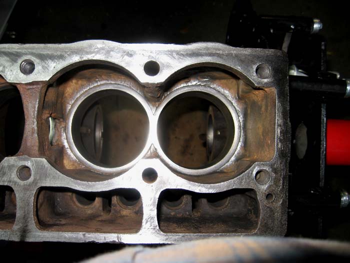

OK, here's some pics. The block needs just a little more wire bushing on the inside. The rust that you see is very superficial. The figure of eight areas are really in very good shape. If you look at the connecting rods, you will see that the second from the left has no grinding marks on it. Apparently that was the lightest one. The other three have been ground both on the rib that you can see, and on the very top of the rod. The valves that are in the head are the originals. None had to be replaced, however, there are new bronze guides in there.

OK, got the cylinder liners in. Three of them measured 0.004" proud, one was closer to 0.0035". Right within spec. I bit the bullet, and bought Moss's Wellseal at an outrageous price to use on the figure-of-eight seals. It's really nice stuff though, and I'll be using it elsewhere on the engine. I'll set the scroll seal next, and call it a day.
