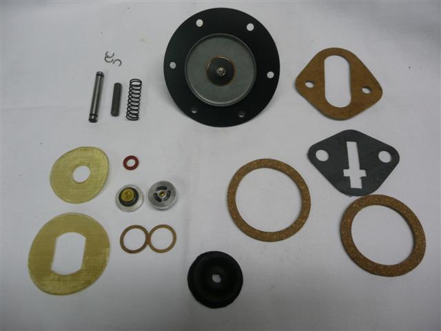

As far as the new kits go, they are designed from the ground up to be compatible with the new fuels, so the diaphragms as well as the valves are made from aircraft grade material to resist the problems that have been seen on some of the "red" kits. I don't know where they came from, but I saw one diaphragm on another forum and it looked like it had been stretched with a heat gun.
Not to debate Randall's thoughts on the valves wearing out, if I were getting a new kit, I would put everything new in that I could at that time, just in case.

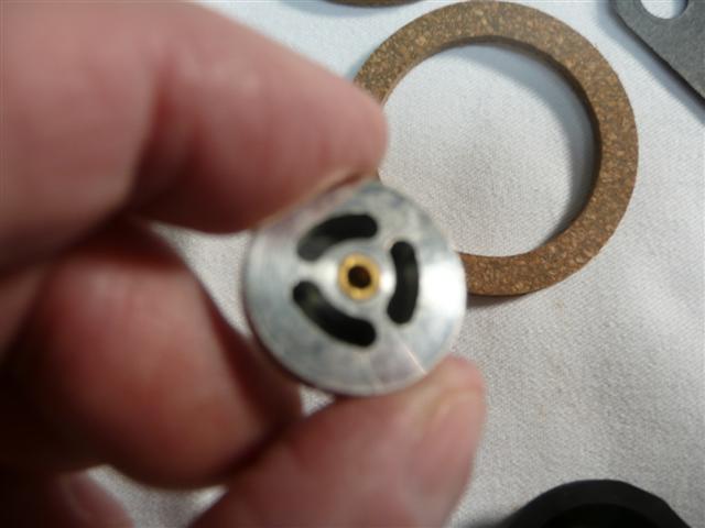

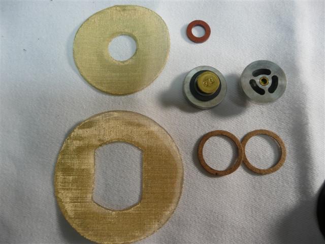

And I just checked one of the kits that is still sitting on my bench and the screens are a brass mesh material, rather than nylon. I have yet to build any of these due to other priorities taking over, but some day soon............

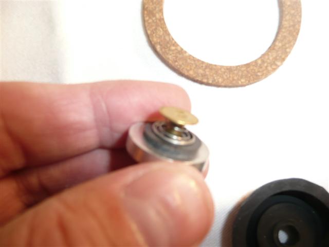

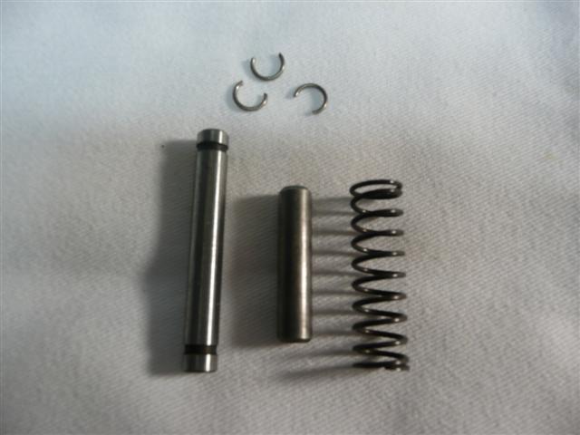

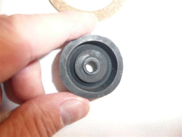

Pictures of the new kit contents are below:
