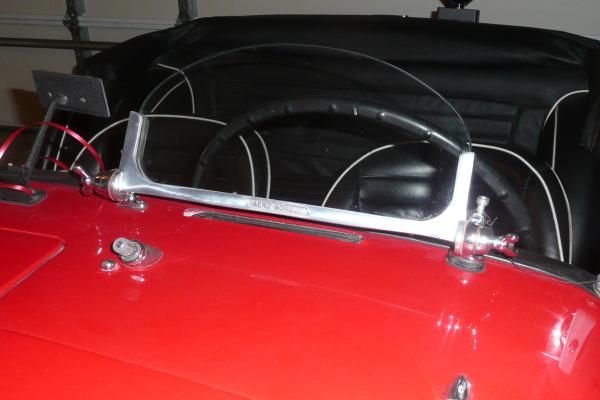

I have a 1960 TR-3A that I'm about to start a frame off on. Going through the mountain of parts I've accumulated over the years I found a NOS set of Brookland Windscreen, nicely wrapped, in a box, with one screen crack (but that can be replaced). I was informed by Mr. Baccus at the BHMT that their records for this car serial number range don't exist which in some respects, opens up all kinds of opportunities. The Vin, engine number and coach, appear to be close enough to be original and while it is a 4 speed, it's has a big old "O" in the VIN so it has to be an overdrive car. As my plans for the car evolve, I am definitely going with the Brookland's on this one but have a few questions. Specifically, what is he proper mounting procedure, in as far as period correct? Are they mounted so the full windscreen can be mounted for those cold winter days or what? Anyone have any thoughts?

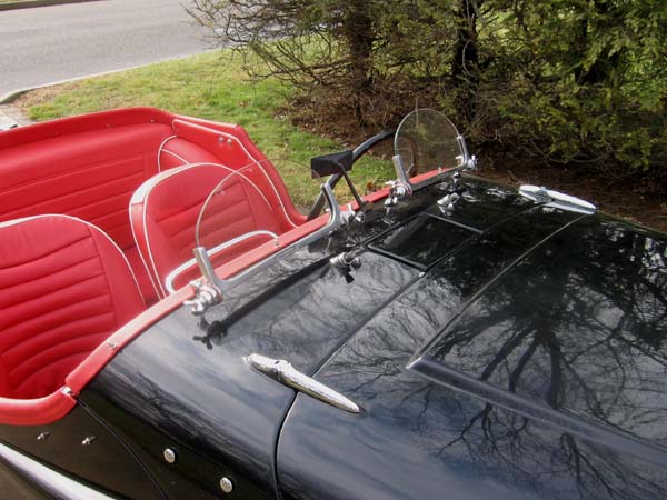

I placed the pedestals so that they can remain in place when the windscreen is on though I remove the screen itself -- I suppose it could be left there in addition to the full windscreen but to me that would look strange.
I did make a sort of 'shoe' to be under the outboard pedestal to make the aeroscreen sit more level -- sort of a thick gasket, made of wood and painted black. Without it the little screen slopes downward quite a bit.

On that theme, don't attach aftermarket aeroscreen pedestals with sheet metal screws. A much safer option is to use metal threads with a flat and split washer under the nut.
Some form of rubber seal between the aeroscreen and scuttle helps keep bugs from streaming through. The factory aeroscreens, also made by Brooklands, had a bottom channel that took a shortened section of the standard windscreen rubber seal. Aftermarket aeroscreens need any such seal glued on.
