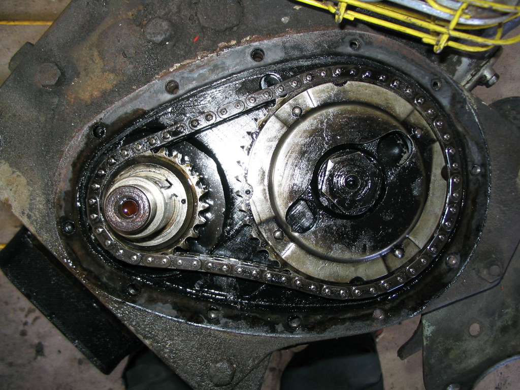

A couple of years ago while changing the oil I saw what appeared to be a lot of hard plastic bits in the drain pan. When I dropped the sump I saw that in fact they were the remains of the timing chain tensioner which had broken and made their way down into the sump--which explained the unusual rattling noise I had been trying to identify for a couple of thousand miles!
Installing the new chain and tensioner with the engine in situ was not easy as getting the front pulley onto the end of the crank with the woodruff key started into the slot seemed at first an impossibility, but after a number of attempts it just happened, and from there on the job was pretty simple. I took the opportunity to install the front cover stifener sold by BCS.
Good luck and keep us posted.
Should you decide to replace the gears--crank or cam, or both--be advised the original cam gear had a metal plate riveted to the gear (I've heard it called a 'slinger,' Moss calls it an 'oil catcher'). To my knowledge, none of the suppliers have this type of gear, they just offer a gear without the slinger. Moss says they supply the rivets with which to transfer the slinger. I installed mine without the slinger with, so far, no adverse effects, but I only have a few hundred miles on the engine.

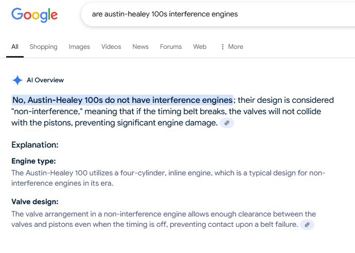

Thanks to all. I'll be replacing both gears, tensioner, chain and some other bits. As has been asked and answered, the 4 cylinder engine is not an interference design so valve damage is not likley. I have everything off but the timing cover and I'll get to that tomorrow. I'll do a differential compression check when I adjust the valves prior to running. The hardest part so far was getting the lock washer unfolded off the crank nut. I kind of overdid that all those years ago thinking I'd never have to un do it.

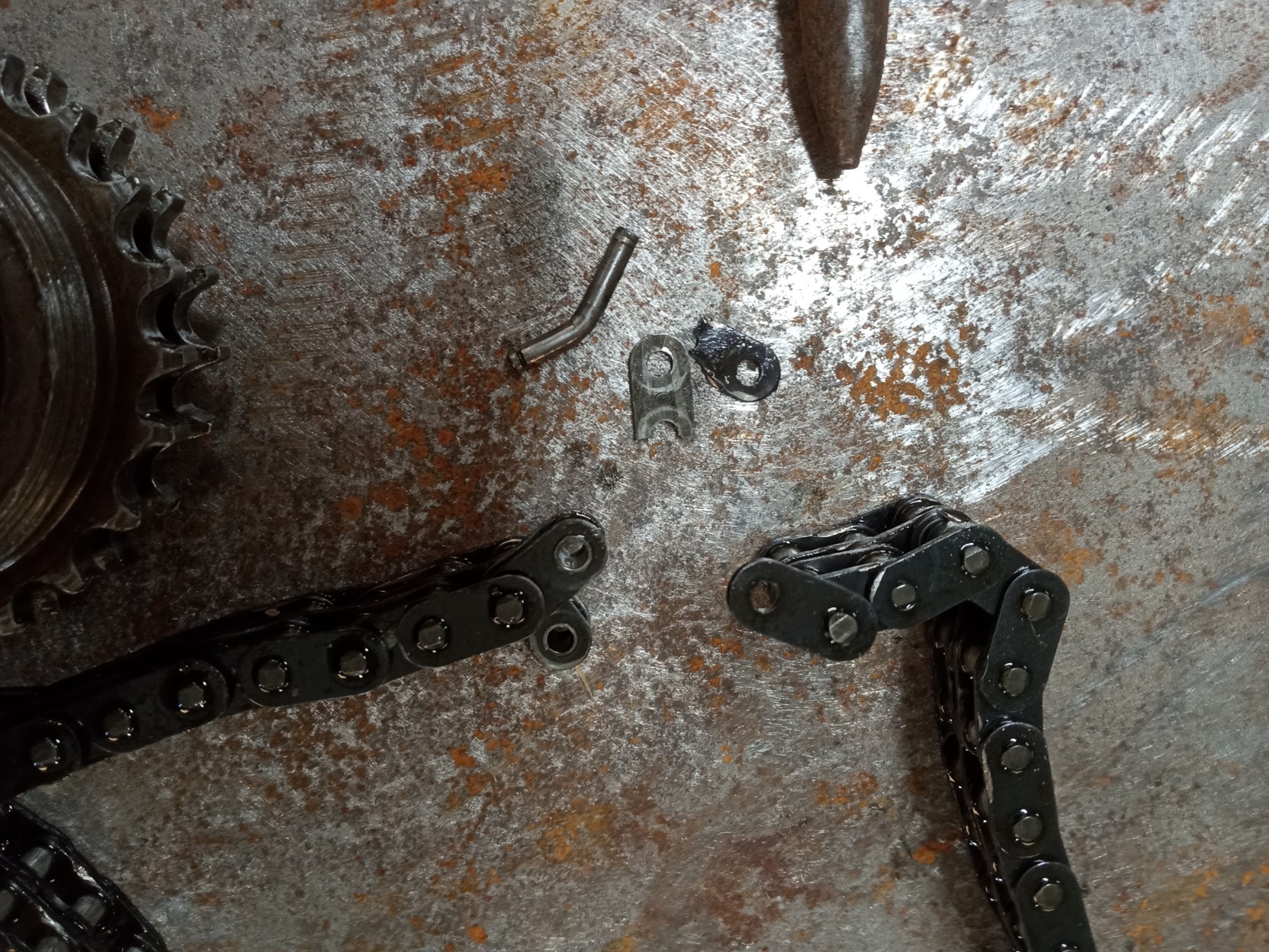

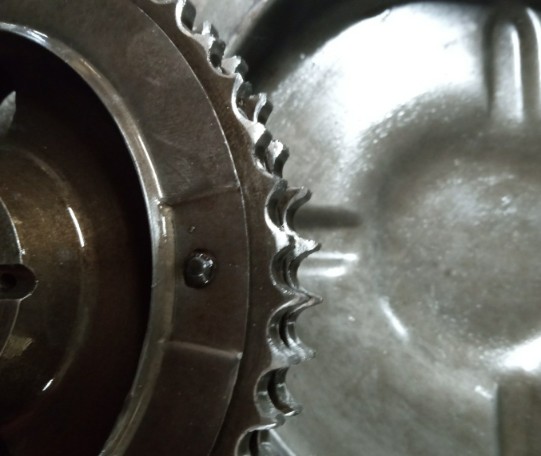

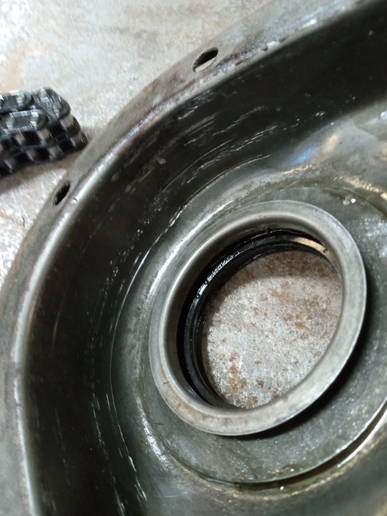

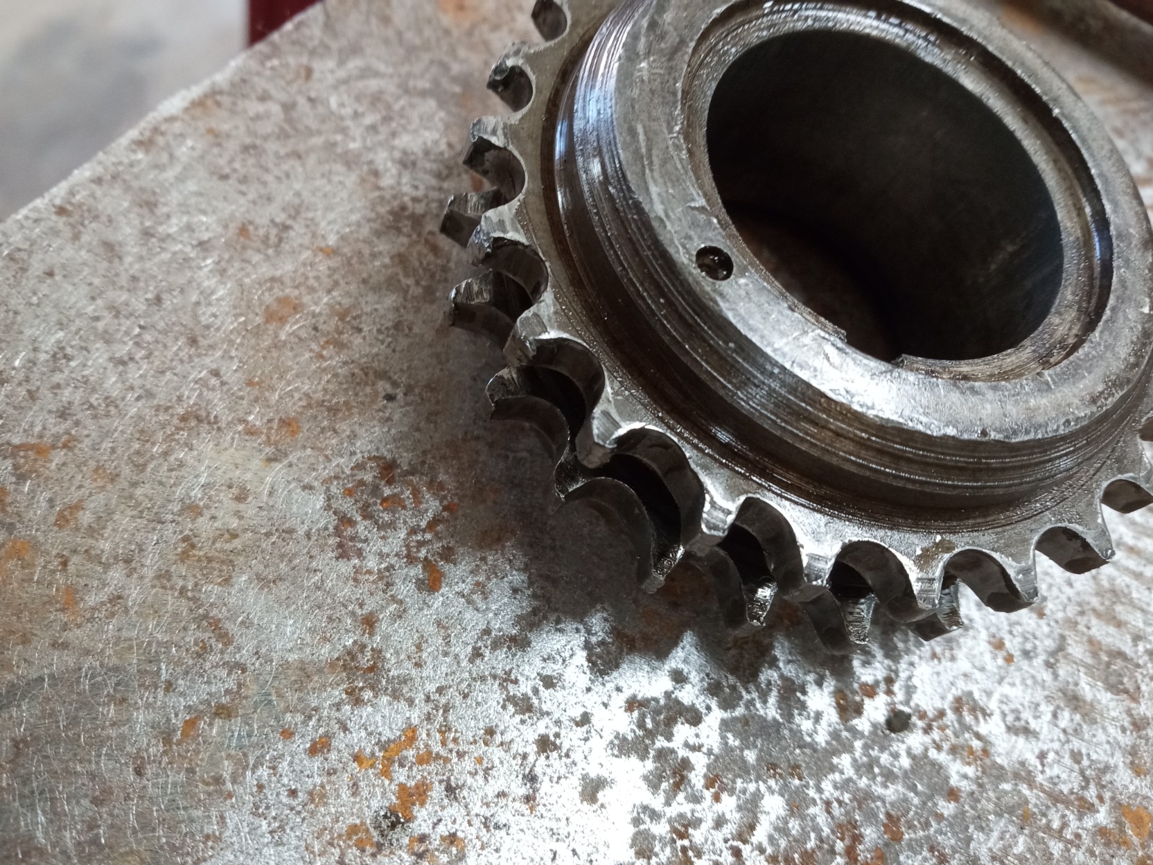

Here are the pertinent images of my timing chain failure. All pieces accounted for. Crank gear shows some tooth damage and some gouging is shown on the bottom of the timing chain cover. I think it is useable, I'll probably replace the seal and hammer out what I can. The cam gear looks good but I'll replace it as I'm pretty sure it is original and likley worn.

One more photo. On looking at the cam gear off the engine, there is some damage and excessive wear visible. 8k miles ago it looked good enough for me to use.

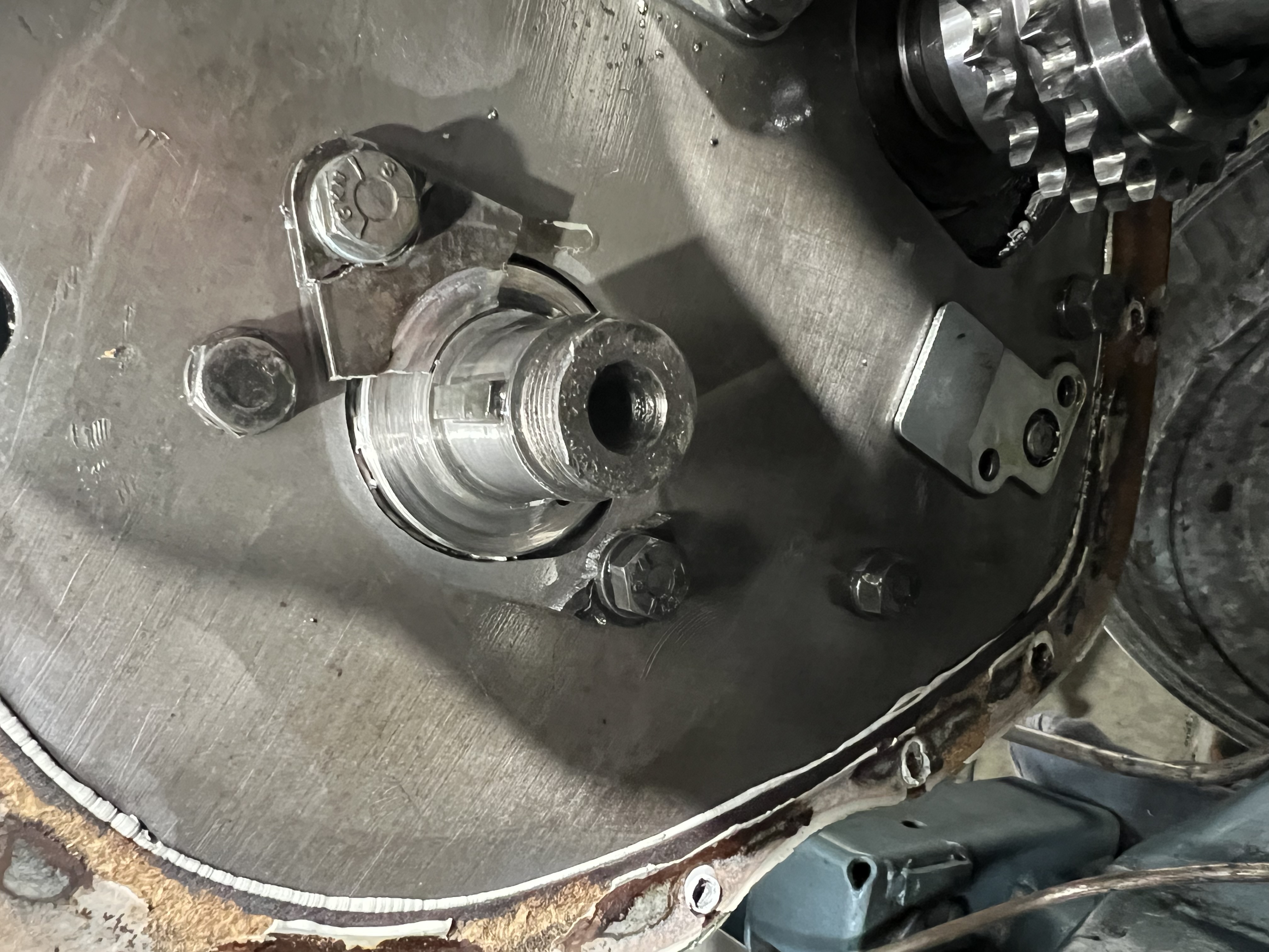

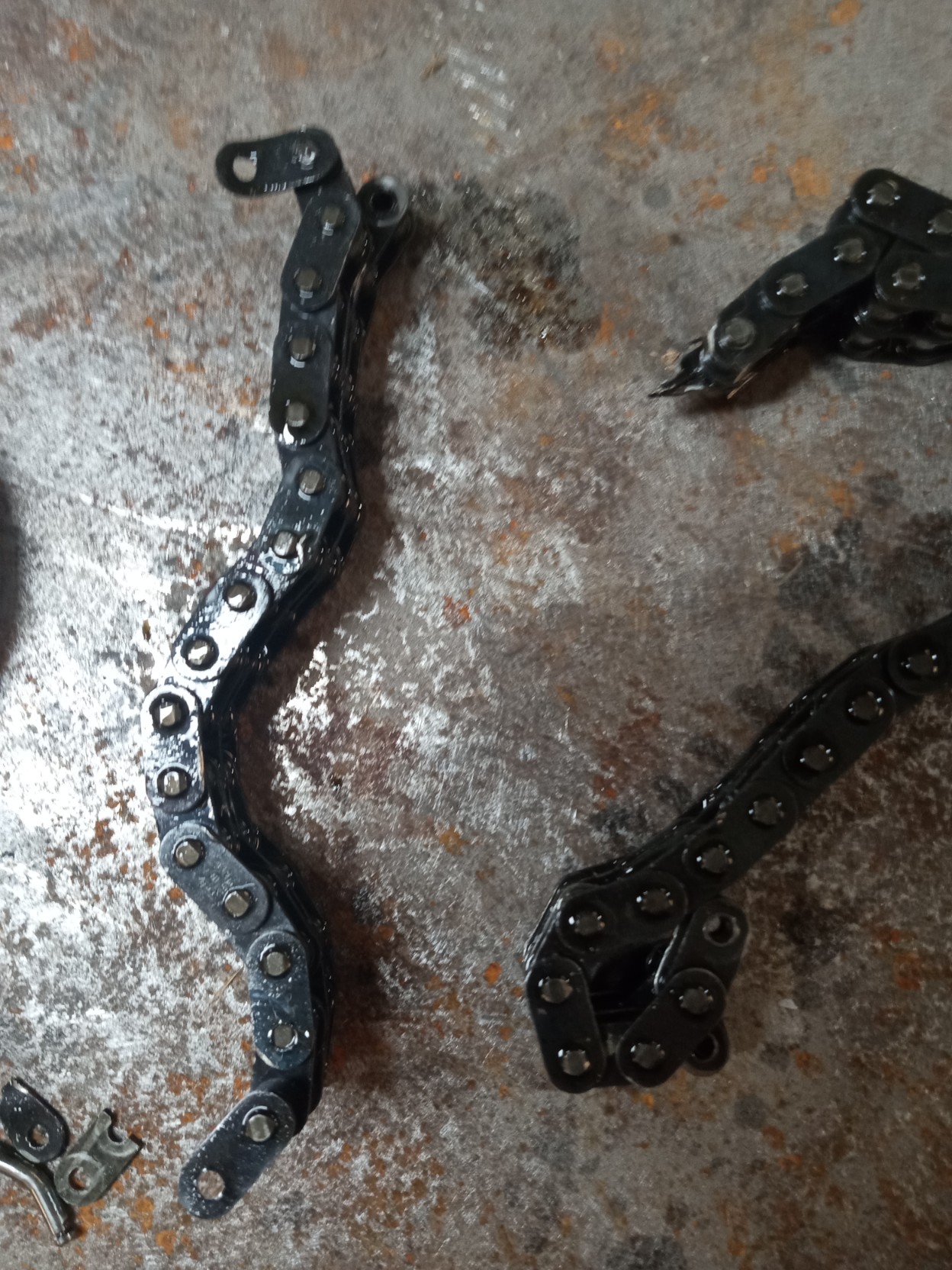

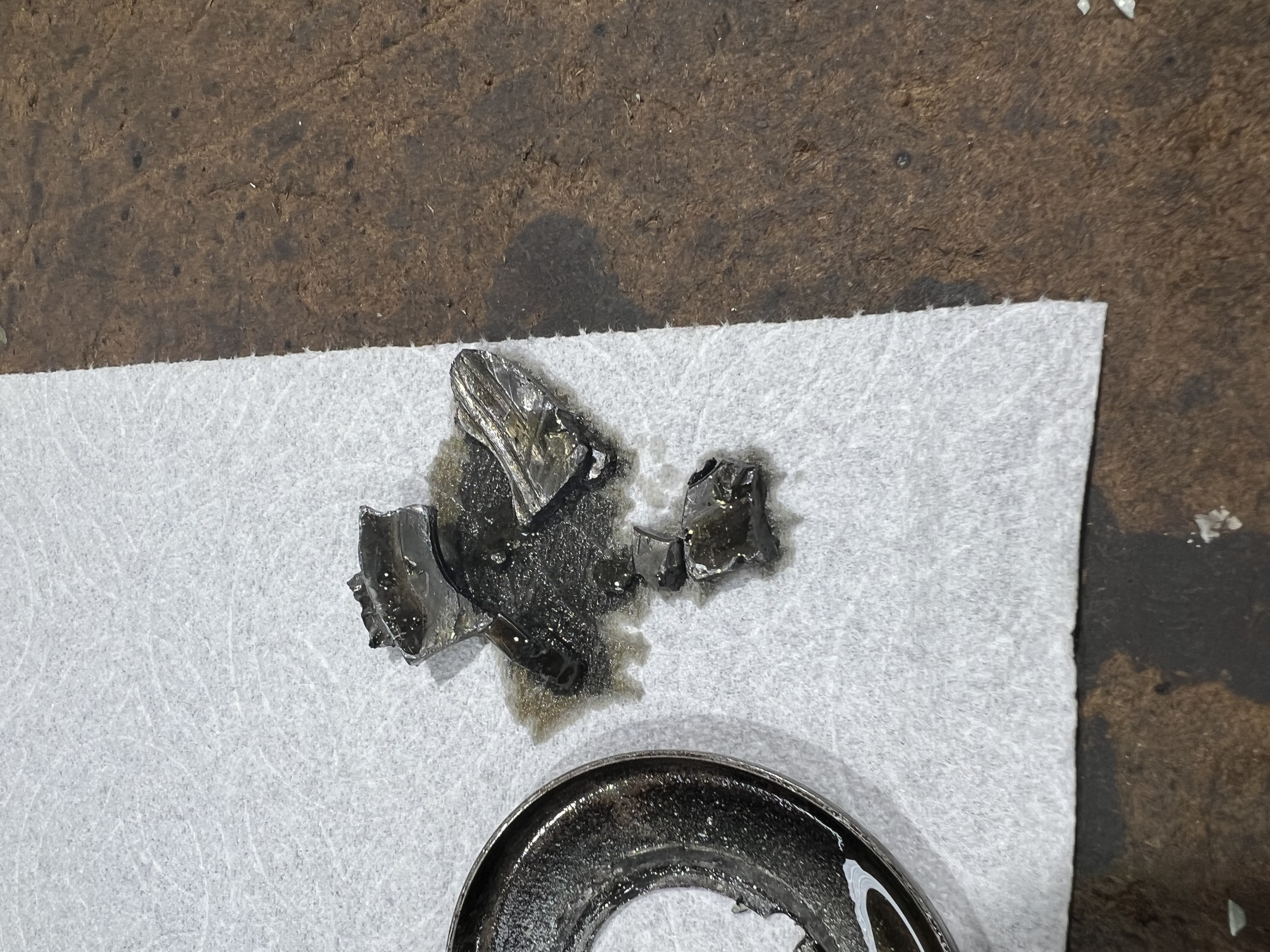

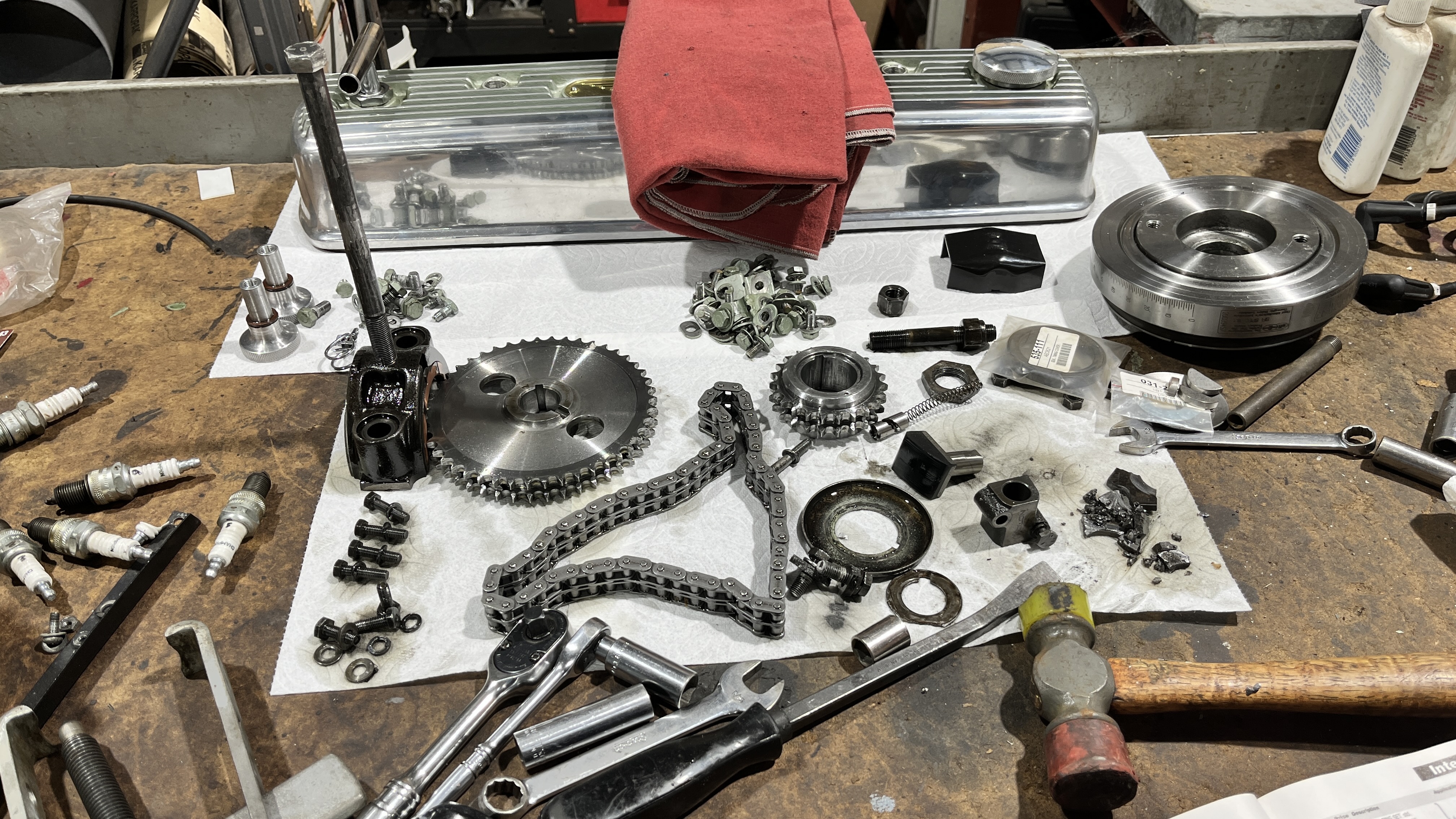

I have a completely rebuilt engine. About 800 miles on it now. 02.18.25 I was driving to a British mechanic to work on the tranny/OD. 88 miles into the 200 mile drive, engine made some studdering, no loud noises. I pulled off the freeway. On the side of the freeway, Engine would turn over, wouldn't start. With the mechanic on the phone, spent about two hours trying things. Ended up getting towed to mechanics place. Next morning, finds out timing chain related damage. Lots of broken parts. Mechanic has been speaking with the machinist trying to figure out what happened.

The cam locating plate (Moss 031-210) is obviously broken and the tensioner (Moss 011-139) looks doubtful (the spring). If the cam locating plate broke, the cam can move fore and aft, which would put a side load on the timing chain and may cause the tensioner to come apart. When the tensioners come apart, everything else gets trashed. The tensioners have the reputation of being the weak link in the timing chain system.
I replaced my timing chain a few years ago, with the engine in the car. The worst part was trying to get a new tensioner installed - once the tensioner was installed, it was nigh near impossible to get the timing chain installed. The advice from several folks at that point was to forget the tensioner and run without since its such a weak link. . . which I did. There was no tensioner when I took things apart. Any updated thoughts on deleting the tensioner?
