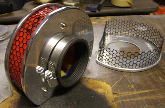

I don’t know if you recall that air cleaner project I mentioned in another thread of yours, but I finished it a couple of weeks ago. The directions for the rod I used said to tin the base metal using a stainless steel brush to spread the molten braze around. I went through a fair amount of brushes when the braze stuck to them, rendering them useless in short order when they turned into blocks of metal. I didn’t have any luck tacking the pieces together. When the base aluminum gets hot enough, several inches of braze would liquefy. I guess working with larger pieces would be easier, I wound up clamping my parts together. There is a learning curve with this stuff, but I was happy with the outcome in the end.
Here is a photo of 1 ½ of the three filter housings I made. The incomplete one gives a better idea of what was brazed.

Hey guy! Those Air Cleaners turned out nicely. Great job.
Yea, as I said I have Not used these type rods or this process, although I have done considerable reading on the subject. Some of the techniques seemed completely foreign to me. I guess because I`m an "Old School" welder haha. I can see where the tinning process using a stainless steel brush to spread the aluminum braze around could be a bit cumbersome to say the least. I would think there might be some easier way.
I read where some manufacturers of these rods say to tin the joint, where as others claimed it was not necessary. One manufacturer even claimed thier product could "wet" the parent material even though the Aluminum oxide was not removed. Some even mentioned getting a good wetting action through dirt and paint. {foriegn thoughts going through my mind here i`ll tell ya} I think I would stick to what I know, clean, clean, and clean then weld.
I can see where reading every thing you can get your hands on about the rod maunfacturer tips and techniques then pratice and more practice would be benneficial. Mabe make the next pair of Air Cleaners out of brass. Hehehehehe They sure would look purtty sittin on a pair of H-6`s
