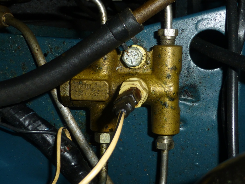

A bit confused; unless there are PDWA changes between years, the PDWA has 2 lines in from the MC, and 2 lines out, one to the front, 1 to the rear.
I know the PDWA is a safety thing, or so they say. But as the MC splits the front to rear brakes in case of failure, realistically how important is the PDWA to use as to going directly to the front/rear directly off the MC?
And secondly, is there a way to test the PDWA is working correctly?

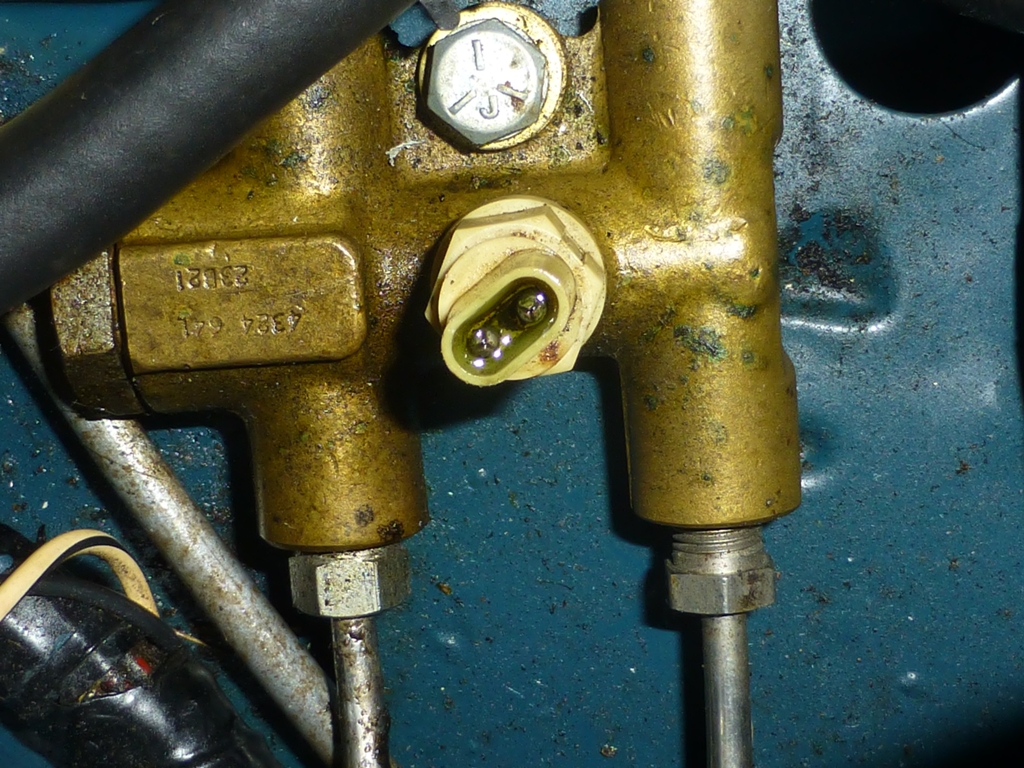

The only issue I am aware with the PDWA are the seals on the shuttle deteriorate and leak. Usually if that happens you can pull the connection for the warning light and see brake fluid in the switch. As far as your question about the need of the PDWA, that is entirely up to you. But just what benefit would you have by removing it?
Thanks, there would be no benefit in removing it I agree with you, but as I am restoring the car and it's all in box's I have to ask the same question in reverse. And that is what is the benefit of installing it other than to know the fluid is leaking? And I'm pretty on top of leaking fittings, and maintaing the car in this regard.
Pat
Well, lets say your driving down this curvy mountain road and have to apply the brakes to make the next hairpin, but the seals on a rear brake cylinder let go about 10 miles back. Bad things might happen. With the PDWA, the little red light would have been on 9 miles back. Having said that, some folks have eliminated it. Your car, your call.
