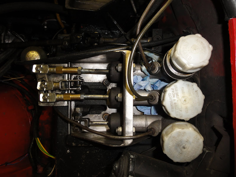

I'm converting to rear disk setup on the Spridget H-car. I decided to simultaneously upgrade the brake m/cyl set-up from a tsock twin-circuit sylinder to a Tilton-style, with separate m/cyls for front and rear brakes, hanging the clutch m/cyl off the side of a stock pedal box a la Speedwell. What cylinder diameters are people using for the dual m/cyl set-up?
I was thinking the baseline would be 3/4" - 3/4". Wilwood cylinders look to be more economical than Girling, plus they come with the mounting options in a kit - remote reservoir v. reservoir mounted on cylinder, etc.
Thanks for any help on this -
