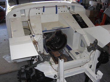

I originally ordered the Moss pre-flared lines for the brakes. As mine is a BE with disk brakes, Moss did not know if their BE kit would fit. Well it should fit fine, just the transfer tubes at the front would not be used. I found that 3 of the 6 Moss lines were too long + I wanted a new clutch and fuel line. I ordered raw lines from Fedhillusa.com The tubes were easy to bend, either the Moss or the Fedhill. I bought a SPX flaring tool (#6504 from Sears) which worked great. Bending the tubing and getting it to fit right takes time and lots of chilling out.
This is the way I would put new lines in next time. Here is my BE so far, with the donor tranny to check the slave cylinder fit and the tubes still need clips, which are on their way from Moss.

Boy, I wish my Bugeye looked that clean!
At least now I know it wasn't only my error that had me winding up with a line too long.
Nice. I just love a clean engine room.
