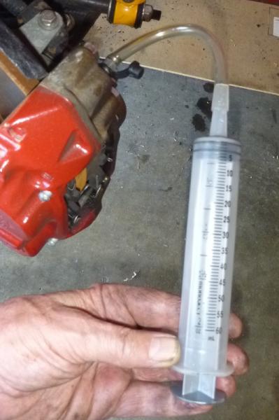

Finally! Pressure bleeding? Didn't work. Syringe bleeding? Didn't work. Mityvac? Didn't work. Tried and true "up, down, up, down" partner method? Didn't work.

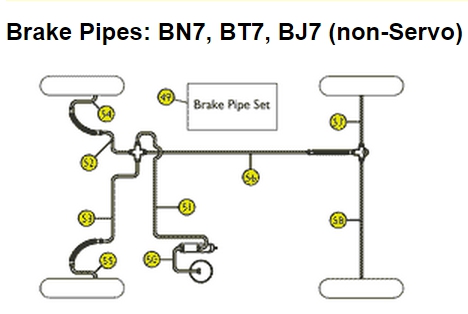

Part of the diagnosis I wish I'd of tried earlier was using fluid line clamps. I clamped down all three lines (front left, front right and rear line serving both rears) and got a rock hard pedal. Note: must use fluid line clamps ($4 from Harbor Freight), pistol grip wood clamps were ineffectual and C ("G" in the old country?) would be rough on the lines. I took the clamps off one by one and found weak pedal for two of the three clamps (right front and rear) so I knew I had air in those lines. That meant I had to try a different method so I pulled out the "emergency stop" bleed method. Worked quickly. Brake pedal is now high and firm.
