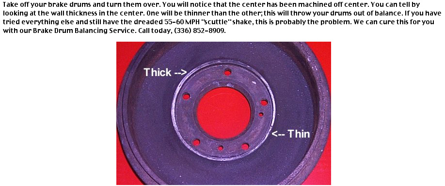

Hi Wana,
If your drums look like the attached pic, it would be well to have them corrected. Sending them to Hendrix would assure that it was done properly. It's not really so far away from you in this day & age.
I have also had tires & wheels balanced by Hendrix (off the car) & they were perfectly smooth.

Hi Dave,
Yes, they look exactly like that. Do you know if Hendrix machines the drums or do they just spin them and add weight? Alternatively, do you know anything about the new replacement drums that all of the Healey parts suppliers sell? If I am paying Hendrix $75 per drum plus shipping plus downtime, seems to me new drums at $89.95 might be a better way to go if they are good quality and balanced?
I'm not sure how Hendrix balances the drums. It could be adding weight to the light side. If needed, I would be tempted to center the hub hole in a lathe & skim the outer drum circumference to true with the center. As is, there must be variation of the outer drum thickness, since the indexing point for machining the shoe surface was likely the off center hole as first machined in the casting. The off center machining may only be a problem with the later cars. My original BN2 drums, front & rear, are so close as is, that they didn't need any work.
I have no idea about the quality of the $89.95 drums. I do know that high quality drums cost about twice that much.
I'm really surprised that you can't find a shop with a 14" or larger lathe, to chuck up on the center hole & skim the outer circumference to true with the center. The inner shoe surface has already been trued to the off center hole during original manufacture.
You could even set the drums on a bubble balancer & add/remove metal as needed to balance. It would likely help a lot.

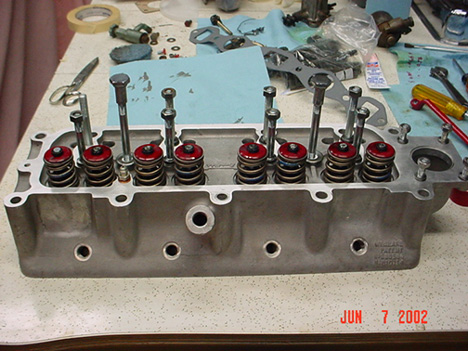

While on the subject of original cast iron parts, i once looked at getting a 100 head cast to original specs, would i be in breach of patent?, same would i guess apply to getting drums cast?
There are a couple of cast aluminum heads on the aftermarket. DWR UK has a very good one that fits as original, has much improved internal port shapes, & revised cross sections to strengthen the original weak areas. It has the same external casting numbers as original & shows the original patent numbers. They also have some high quality brake drums. See attached head pic;
