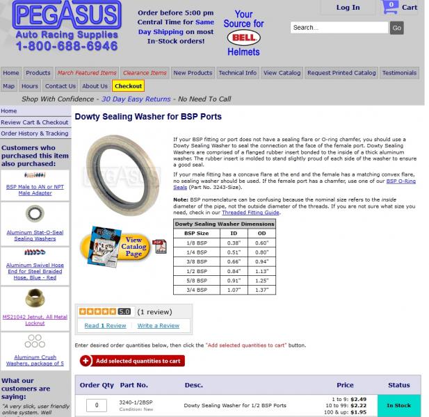

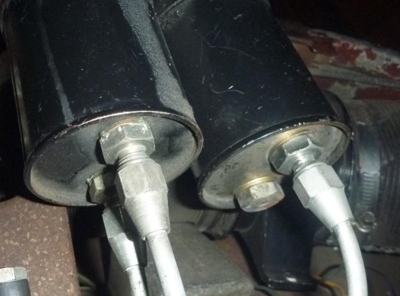

Dowty sealing washers, 1/2" ID are the way to go with the stock tanks - this installation is a couple of years old:

The above seems to imply you're using the wrong washer if it gets tortured when you tighten it enough to be difficult to remove. The advantage of the Dowty design is you can tighten it really well without distortion of the seal.

The Dowty washers look like good items and your pics show a good job. I will order some for my inventory but I have also just ordered a new can from Healey Surgeons.
