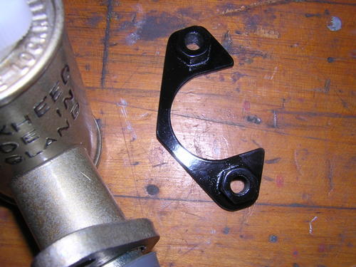

I just got my stuff back from the powdercoater, and want to get the master cylinders installed. I saw on another forum a handy thing to make getting them installed much easier. I'm not sure if anyone has posted this here, but what I am hoping is that someone here might be making them up for sale.
I would make up my own, but I don't have access to a welder.
I have read that one can install helicoils into the master cylinders to take care of threading them up, so if I can't figure out how to make up the brackets, I will give the helicoils a try.
If I had a pattern for that, I could make tons of those.
I have been giving the picture a look, and I think I am going to get some aluminum stock, about 1/4" thick, and make up one of those, and just tap the holes. Probably a bit of work, but I have lots of free time :smile:
