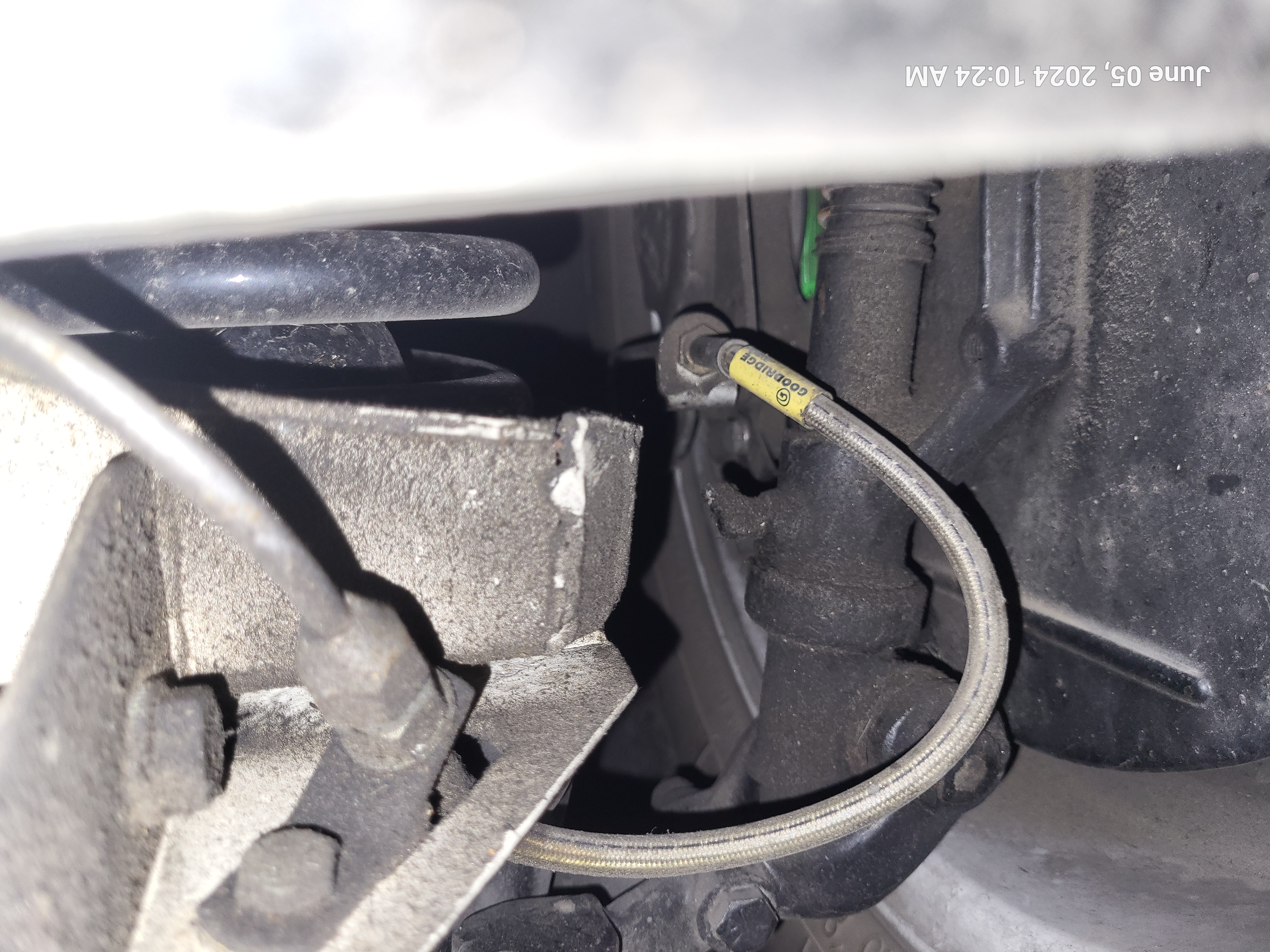

I have just received my front Girling calipers rebuilt by a brake specialist local shop. They look great.
Before requiring help, I spent some time on the search button without success.
I have spent some easy time putting them back on the car, but I experience a small disagreement when it comes to connect the two ends (line connecting from caliper to the other end). I cannot make it right.
Would anyone provide me a photo so I can take a see why the line does not fit (the line is the original then there are no reasons why the connection can be made), we have modified the shape, size or length.
In advance, Many thanks

Have you put the caliper on the correct side of the car?
The pipe should connect to the bottom of the caliper with bleed nipple on the top.
Just a thought.
