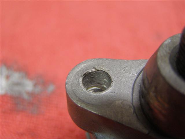

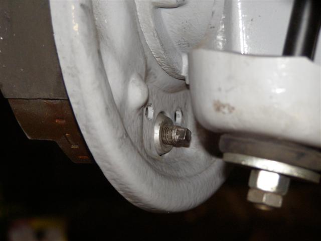

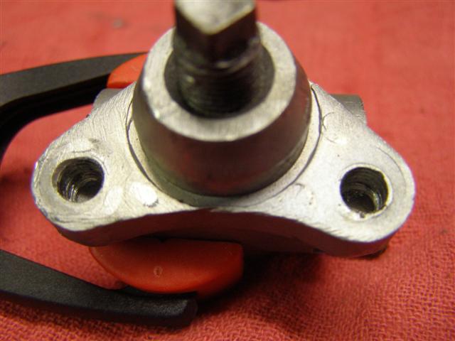

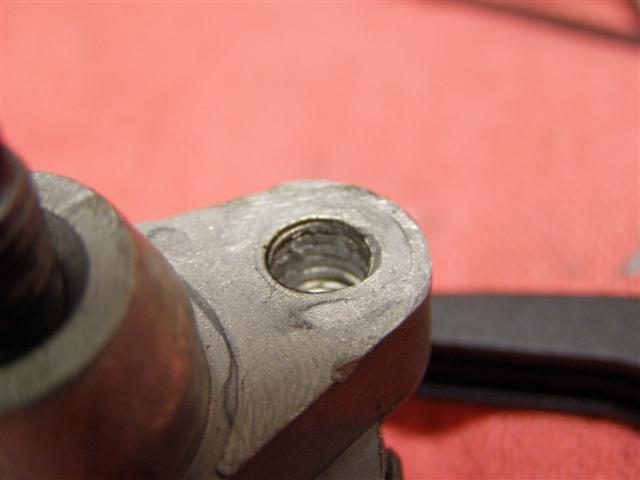

Here is what actually happened. The studs just came out and there are virtually no threads left. I can assure you that these were NOT over-torqued because I took the other side off and they were tight, but certainly not stripped or over tightened.
My original Girling's are rebuilt with a thin coating over Never Seize inside on the pistons and the housing and on the adjuster threads and we're back on the road to the body shop.
This could have been a lot worse. I've been told by some on 6-Pack that they're gone through multiple sets of these from all of the Big Three, as they all use the same source.

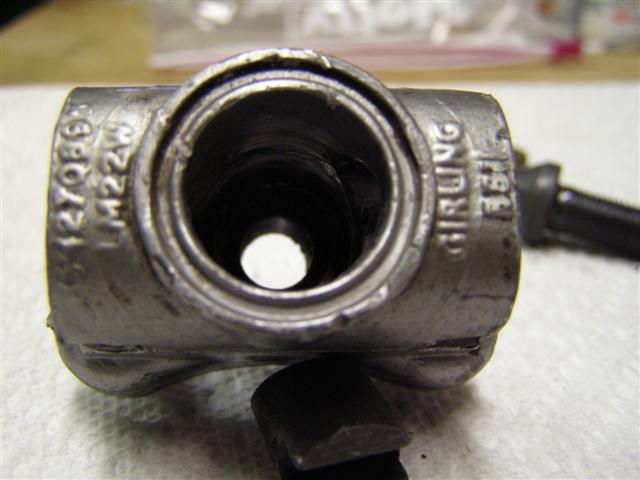

No branding or logo or name on any of the castings. Girling's are clearly marked as shown below.
EDIT: Sorry!
Randy,
No Rover boxes. I did read somewhere that those were good units.

Couldn't you just Heli-coil the adjusters and reinstall using SS hex head bolts?
I know it may seem like over kill but thats how I roll.
Dane,
Welcome to the Forum. I sure could do just that and I probably will (just to keep these as spares) after I take them apart and make sure that the threaded portion that the adjuster rides in is OK.
The point of the whole thing is that this should have never happened at 1,200 miles or even 12,000 miles. I almost ruined a brand new Alfin aluminum drum, let alone the potential to lock up or lose brakes altogether.
