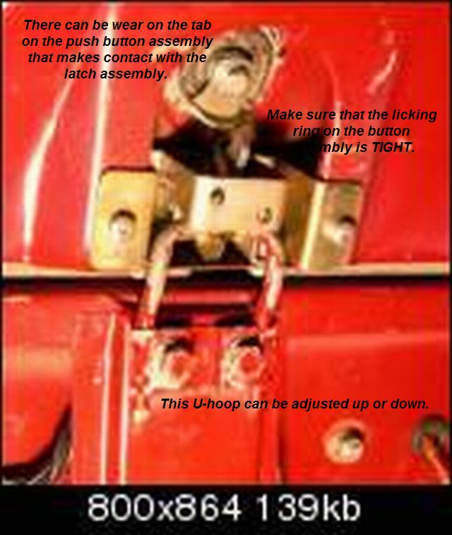

Now be sure that the lock ring for the latch button is TIGHT.
As most of us know, those latches can be a little disheartening at times and this is a maintenance thing that gets overlooked a lot until the trunk won't open. It's pretty cramped in there, but have a small person residing in the trunk with a flash light, <span style="text-decoration: underline">if you have one handy,</span> while adjusting the latch, making sure they know how to release it from the inside! :jester:

After several attempts I stumbled upon an adjustment that works just fine, and tightened everything real well. This one is solved, for now at least.
