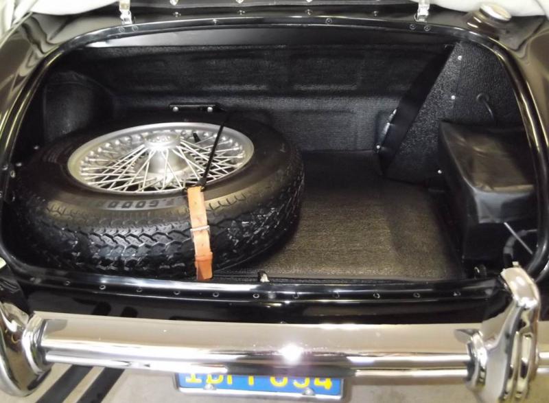

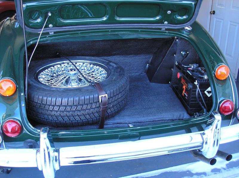

I have used the one from John Skinner in the UK and it worked out quite nice.
Before and after pics, used the instructions from Rich Chrysler
Both my BJ8 kits came Moss I think , installed by me , not a difficult job but the backing stuff they use is itchy .
I also have a good useable kit if your looking to safe a few $$$$
PM for details .

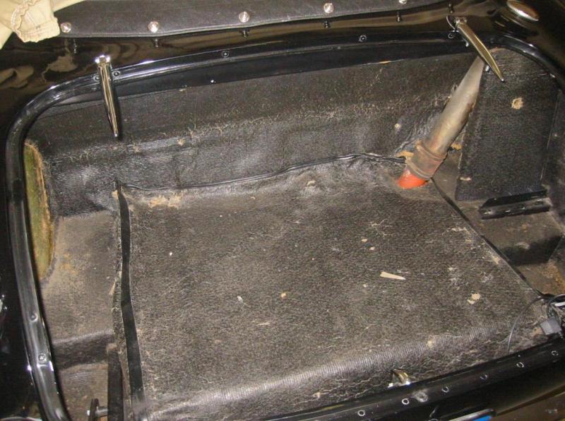

Hi Steve,
As I remember, the boot of the phase 1 BJ8 was finished in Armacord layed (not glued) over the fuel tank and glood on the forward panel and two sided panels. There was a cheap looking piece of leather-grain imprinted cardboard folded around the 2 sides and screwed into the fuel filler housing. An equally cheap looking piece of thin vinyl heat-formed for a battery cover and the base of the spare tire securing rod was covered with a piece of leather-grained vinyl material. All vinyl coverings and other, along with the Armacord coverings and flooring were Black in color.
Hope this helps,
Ray(64BJ8P1)
