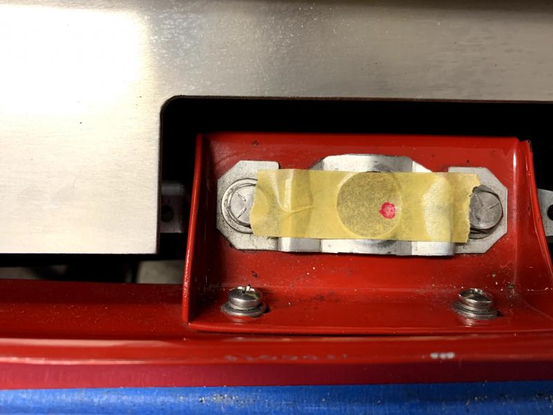

Just a word of thanks to those who responded to my appeal for tips to install the striker pin assembly for the bonnet. I appreciate all responses but especially wanted to thank Roland Wilhelmy for reminding me about Roger Moment's article entitled "trial-fitting Individual Parts." Roger's suggestions about how to install the pin assembly are detailed and offer warnings on what to do to avoid problems.
Kent Lacy suggested "covering the striker hole with tape. Run your finger around the taped hole until it’s visible. Put a drop of paint on the tip of the striker and close the bonnet slowly until the paint drop is in the center of the hole on the tape. Replace tape each time it’s not correct. Trust me you want it to work the first time." I did this and found this to be a great tip. The photo shows my first attempt, but I was then able to easily adjust the position of the pin to get it centered. The unlocking mechanism then worked perfectly on the first attempt. Thank you, Kent!

Installing the hood (bonnet) striker assembly was one of the jobs undertaken today on the 100-6 reassembly project. I recalled reading the tip above about putting masking tape on the lower part and paint on the tip of the striker. That method didn't work well for me, possibly because the paint used was too thin and ran off. A minor modification to the method solved the problem. It occurred to me that a dark colored grease would work in place of a heavier paint. A bit of grease on the fingertip, deposited on the outer circle of the upper striker, did the job well. It left a nice circle on the masking tape, showing exactly the direction and amount of adjustment required for an accurate meshing of the upper and lower parts. Locked and released well the first time the hood was pushed down all the way.
