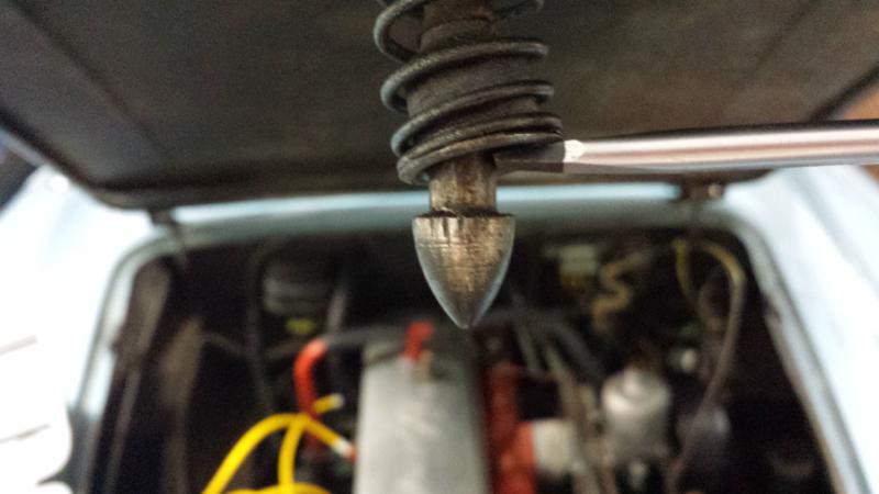

My hood always wants to pop up and not stay latched. I've adjusted the pin on the hood without any luck. The attached pic is the underside of the sliding latch, is it normal for the metal to be at that angle or is it wore out? The pin appears to be ok. Thanks
Ok I got it, turns out the previous owner put the slider upside down! The wife tells me the hood has always popped up since she has owned it the past 20 years. Slowly but surely I'll get this car back to where it should be.

Also, if the piece that the pin goes in to is not level, if it is slanted down, gently pull it back up to level.
