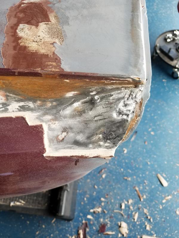

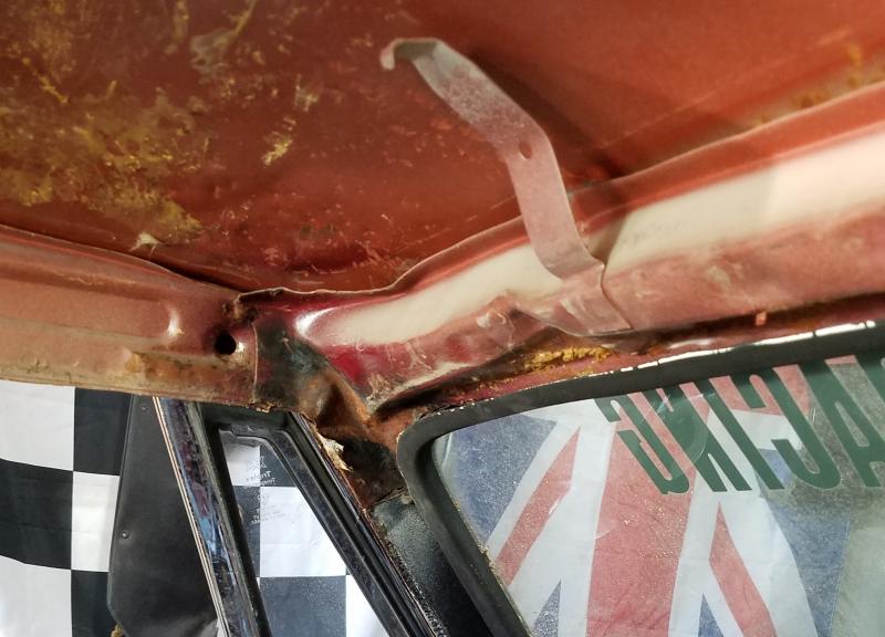

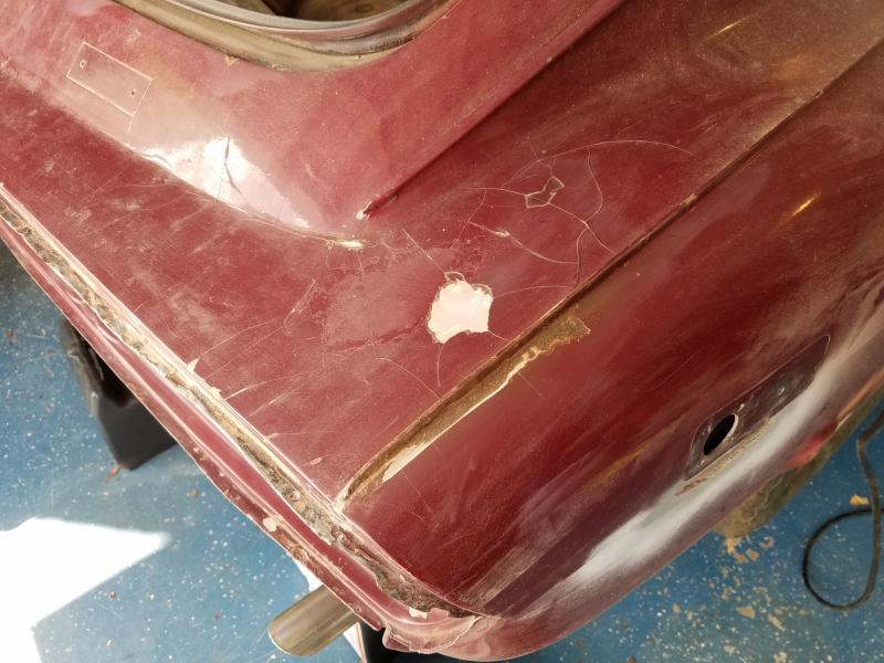

I have been working on the tail of my GT6 Mk3, what a mess! Removed loads of Bondo (up to 1/4 inch thick), revealed wavy dented panels with poor repairs. I am attempting to straighten things out, but I'm not a skilled metalworker. And then I still have to replace the floors and rear wings. I may be in over my head.

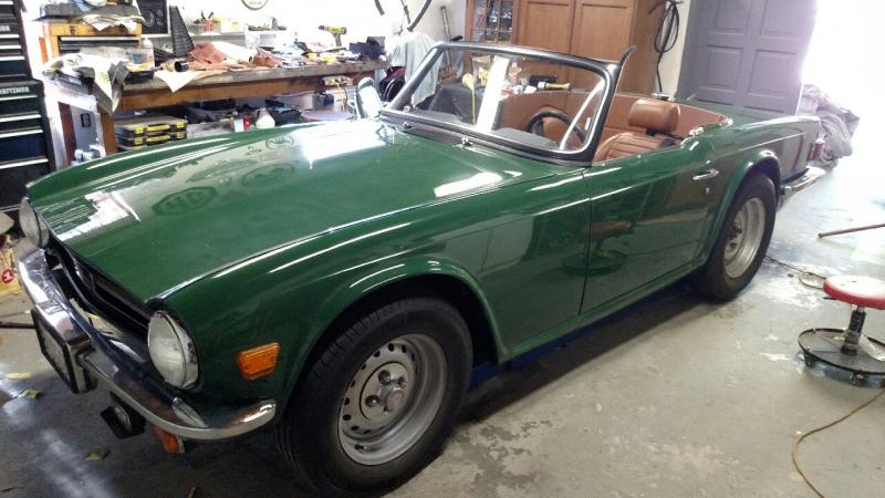

I took a class at the local junior college to learn body work, paint and welding. As a result, I turned a pile of parts into a real nice looking TR6.

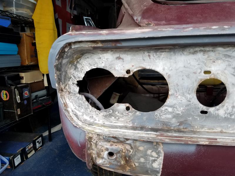

Thanks for all the encouragement, you're right that it can't be worse if I fix it at all. I broke out my body hammers & dollies set and got to work on the taillight panel. I'm surprised at how hard you have to whack the metal to get it to move at all. Most if the dents are small and many seem to be on the reverse side of where the various brackets are welded on the inside of the panel. There will still be filler, but less than what was there.
So one of the things taught in my body repair class is that big hits are a no, no. Lots of small taps, taps, and more taps. Sheet metal repair is thought to be like massaging the metal, not beating it into submission. Take my suggestion if you want.

One other suggestion: If you have a deep area that you can't get the dent out, or need to mold the area to fit an adjacent panel, use fiberglass kitty hair first. It will not absorb water or crack. Then a thin layer of bondo on top to smooth it out.

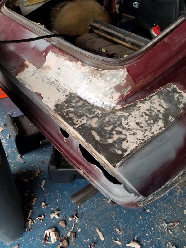

Here is what I first started with on the RH side 20200410_150127.jpg and here is what I found 20200519_164211.jpg
You want to minimize filler, but, as mentioned, it got a bad reputation in the days when people tended to grind out rust in the fender wells and rockers sanded it and painted it, only to have it swell and rust through in a year or less.
Modern filler over properly prepared, solid metal shouldn't shrink, swell or lift. Still a good idea to minimize it's use but do the best you can, rough up the metal finish for good grip, then start the various steps for getting that smooth nice finish.

The number and variety of dents in this car amazes me, and I now think the entire car is coated in thick bondo. 20200905_134827 (2).jpg I don't even know how you can get a dent like this!
