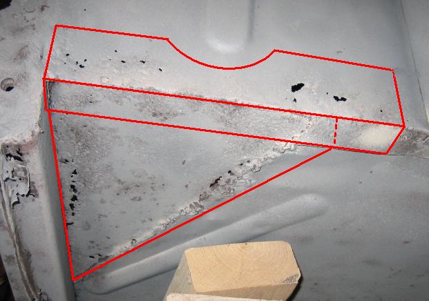

Those black spots are pinholes in the metal.
Initially, I considered plugging the holes by brazing them. Now, with the paint off, there's a bit more rot than I had hoped. Everything still feels strong, but I'd like to make it right before we recover it with paint. Should I have a professional come in and repair this panel? I think it's just beyond what I'm able to do myself.
YMMV - but I'd say yes. I've learned to do non-structural welding where strength but cosmetics don't count, but that would give me pause personally.
The cars value should support the work, not to mention that you want to get the section right.
I had a bunch of pinholes in my floorboards. Since I am not going for a 100 point car, just one I can really enjoy and not have to worry about, I laid some fiberglass on the inside and covered it all with Por 15 silver.
It looks like it worked out ok.
Looks like the original patch was not done very well. I would have it repaired. While I am aware that a lot of people frown on brazing, but if that is a skill you have mastery of, go for it. Cut out the old metal, fabricate new patches with a small flange to fit over the old good metal. Then braze it on.

I'd say new patches would be easier, particularly if you can bend them up in advance (temporarily position with sheet metal screws) and have someone weld them in. It shouldn't be too $$, particularly if you have other welding to be done. IMHO you'd be happier with that in the long run than fiberglassing or brazing (the latter being almost as much work, without any of the structural solidity.)

I agree that patches would be a good solution (based on what I see in this photo). However, I might be more concerned about the condition of the sill/s. Looks pretty bad on the outside and may be rotten inside as well. Solid sills are a must for a successful rebuild.
