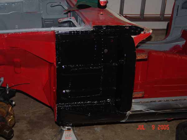

Pull the splash panel and see what lurks beyond. Probably a good bit of rust. That is were they all get it. You need to fix that first before you paint, or the rust will rear it's ugly head again and spoil your job. Probably the splash guard extension has rusted out. I had to replace both of mine as well as my LS trumpet. I will attach a photo of my bulk head, now coated in POR-15

Nice job Gary...but what really impressed me was the neatness of your garage! /ubbthreads/images/graemlins/shocked.gif
Bruce /ubbthreads/images/graemlins/cheers.gif

Well the floor is since marred by welding and working on cars. I really didn't paint the floor to make it look nice as much for other reasons. The additional light is very helpful from a white floor. Having the concrete painted makes it easier to clean the floor. The painted floor doesn't soak up grease, oil and the bare concret cannot be swept as clean. Unpainted concrete is always breaking down creating dust. When I clean the floor I typically do it with a bucket and rag on my knees. I will probably re-do it when the car is done. Either way it's not as nice as it looks in the photos. The shop was new at the time and I hadn't done any work in it yet.
