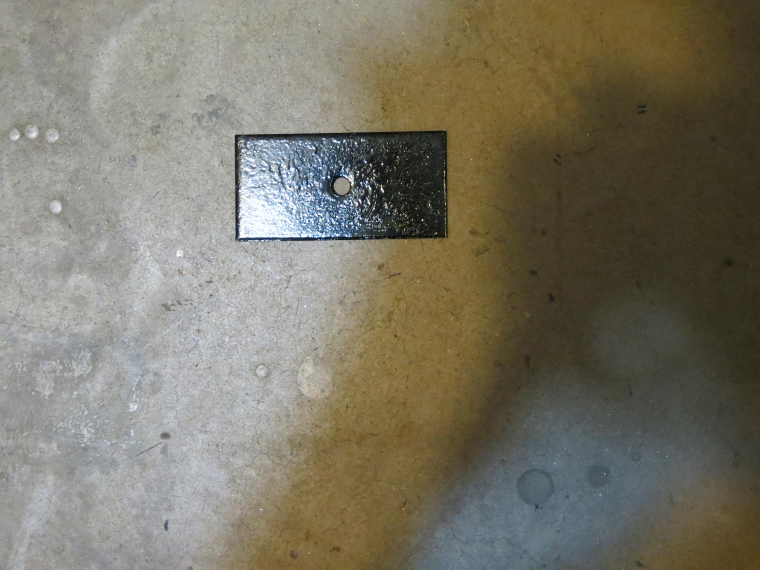

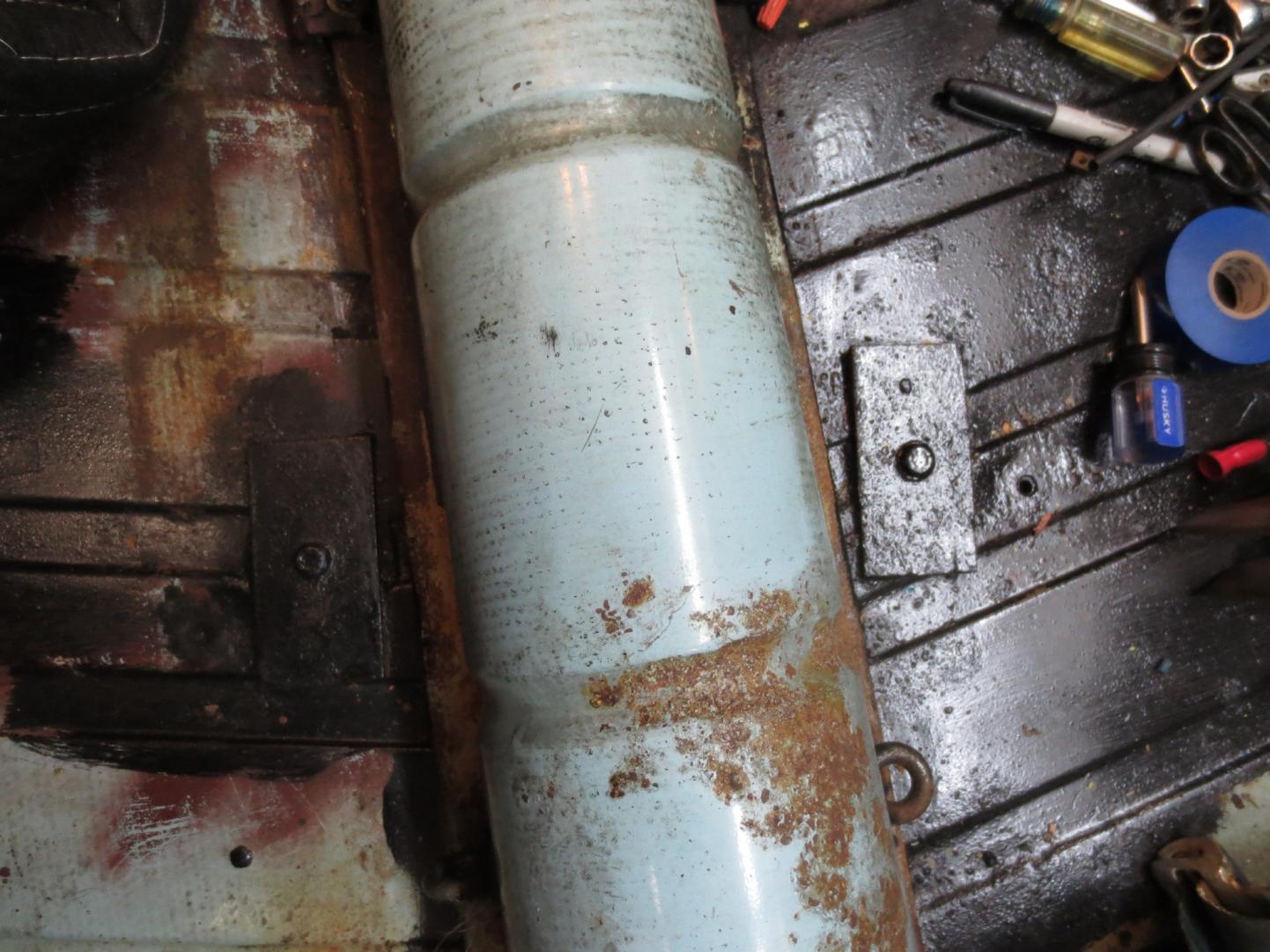

I can't recall where the two 2 inch by 4 inch mounting plates go on my TR4A. Do they mount on the frame before reinstalling the body or go on top of the floorboards and in what area of the floorboards?
Thanks, Pete
Mink, thank you for the photo. It answered my question. I had almost given up on figuring out where they went. I checked numerous parts catalogs and repair manuals without any success. Pete
