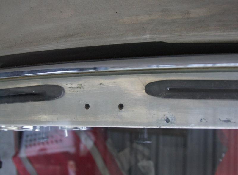

Re: bn6 tonneau cover
The dash top mounting points include a turnbuckle on each corner, and a Tenax stud in the center, just to the right of the mirror. Turnbuckles are held by sheet metal screws that go through the dash pad and into the shroud. The Tenax stud also goes through the dash pad, but has a threaded nut to hold it. With the pad removed, the holes and nut should be visible, unless there's been some changes. On most of the new tonneau covers I have seen, snaps and fasteners are included, but not installed.
Bob
Picture of the mirror thread holes and the tenax location:
