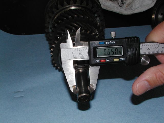

Hello, I am looking for some information from one of you Healey gurus. I have a 59 BN6, and I am currently rebuilding the gearbox. After having stripped it all down, I found that the end of the mainshaft that sits inside the first motion shaft has been badly repaired at some point during it's life. I will be sending it off for repair, and as best I can measure the undamaged section, it appears to be .755 of 1 inch/ 755 thou. Can somebody please confirm this is the correct diameter?
As I said the car is a 59 BN6, but appears to have had a MK1 BN7 box put in it, should that make a difference.
Thanks
Attached is a picture with what I think you are asking.
Let me know if you need anything else!
Thanks,
Duane

Thanks very much for the picture. That's exactly what I was asking! Did you have that picture on file or happen to have the box apart and take it to answer the question?
As I said my car has a BN7 box in it (the laygear is definitely a BN7), either because it is a very late BN6 (which I would prefer), though much more likely that at some point in it's life it has been swapped over. I know that BJ8s and BN1s/2s had different first motion shafts, but I assume the sideshift gearboxes had the same measurement I was asking about??
Anyway, somebody I know had said that it should be .655 (off the top of their head) and your pic backs that up.
Thanks a lot.
I have a spare gearbox for my car, so I took it apart for the measurement!
According to Moss Motors, there are 4 different mainshafts for the 4 speed gearbox, but I do not know what the differences are.
