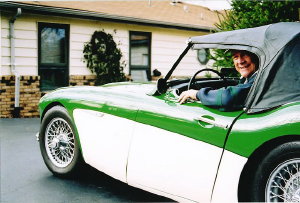

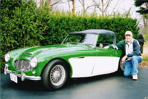

Yes, my green/white Ah is a BN7. Sorry I don't have any installation photos but here's a couple pics after installed.
