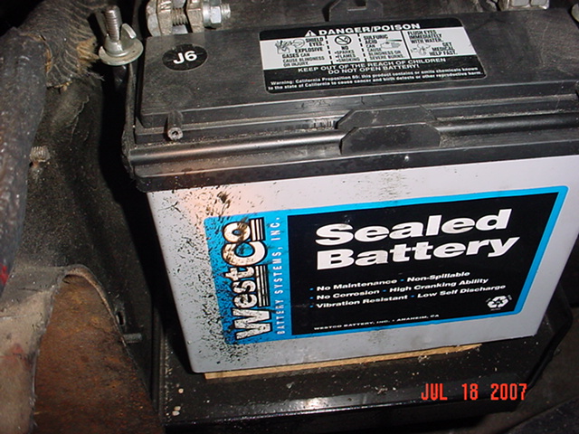

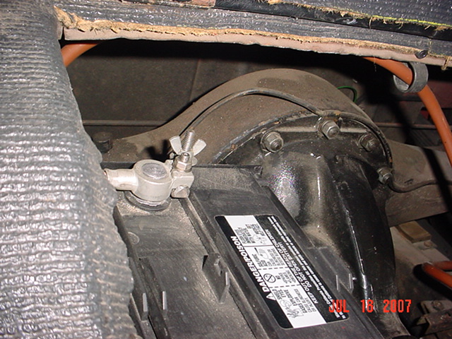

Hi Bill, Can you supply a picture of your single battery installation then we may be able to suggest methods to get the cable out of harms way. I like the Idea of a single 12 volt unit >---Fwiw---Keoke
I believe your car originally had the RH battery connected with one terminal going to the starter & the other crossing over the center to the LH battery via a short jumper. The LH battery then went on to ground via the cutoff switch. The cross jumper was anchored with a cable clip near the center of the hinge mounting surface. High out of harms way.
If the 12 volt battery is located in the RH box, you could use a longer ground cable across the top jumper from the battery to the original cutoff switch.
Alternately, you could create a new ground point on the RH side & run a shorter ground cable.
I mounted a 12 volt battery in the RH box, crossed over to a new battery switch mounted behind the drivers seat, & then to the original ground point. See attached pics.

Thanks Dave for the detailed info and photos and to everyone for their replies. The photos are exactly what I was after. Needless to say the car isn't getting driven again until this problem gets sorted
