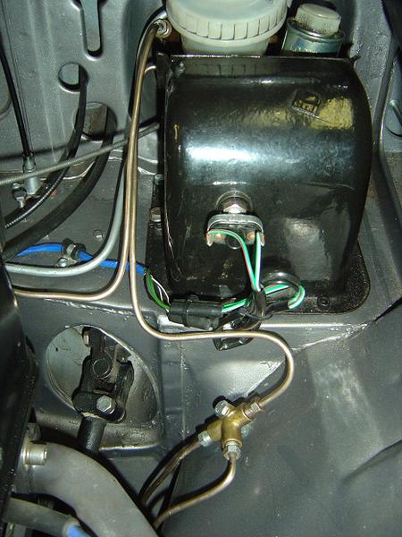

I have a 1953 BN1 that I rebuilt over 12 years and have had on the road since 2002. I have used silicone brake fluid since I rebuilt the car and I have had no problems other than having to replace the hydraulic brake switch several times as it requires significant pressure on the brake pedal to activate the lights.
This appears to be a common problem with hydraulic brake switches when using silicone brake fluid.
I would like to fit a mechanical brake switch but it is not a simple job as unlike the six cylinder models, on the BN1 the brake pedal pivots on a shaft under the floor.
Has anyone fitted a mechanical brake switch to a BN1 or BN2 and if so what sort of switch did you use and how did you fit it?

I've had the same experience with ester-based (non-silicone) fluids and I believe the problem is inherent in the nature of pressure switches: the membrane through which pressure is exerted simply hardens up with age and as time goes on becomes less and less pressure-sensitive.

Thank you Michael and Danny for your responses.
Michael I suspect that you are right about the membrane in the hydraulic switches as I have had to replace them regularly and they seem to work alright for a while and then you have to stand on the brakes to make the light come on. I think a mechanical switch would solve the problem as I am never quite sure if the lights are working or not.
Danny I have a similar switch on my BSA Golden Flash and thought I could use a similar one on the Healey. The problem is that switch has a pull action and the brake pedal under the floor pushes forward from the footwell floor and there does not seem to be any room behind it to fit a switch. If I fit a push-in switch in front of the pedal it is very exposed to the elements.

As you can perhaps see from my owned vehicles I vintage race (the Elva and the Ginetta). Before each race all cars must pass tech and one of the things they check for is brake lights. Yet it is very common for me to see cars whose brake lights are not working on the track and that is because when they go thru tech they stand on the pedal and the lights come on, whereas in normal braking with moderate pedal the switch does not close. I regard the pressure switches as maintenance items to be changed annually on all my cars.
Hi Michael. As I am at a bit of a loss on how to neatly and effectively fit a mechanical switch to my Austin Healey BN1, I think I will have to do the same as you and make changing the hydraulic switch an annual maintenance job. I have searched numerous websites and forums and although fitting a mechanical switch to the later six cylinder models is a common modification, nobody seems to have come up with a modification for the 4 cylinder models with the under floor mounted pedals.

I know this is an old thread but I think I may have solved my problem and thought it may be useful to share the results of my research.
Just to reiterate, my problem was that I had experienced difficulty in sourcing a hydraulic brake switch for my 1953 Austin Healey BN1 that could be used with silicone brake fluid. Although Hella make a switch that fits, they advise that the switches are unsuitable for use with silicone based brake fluid. I have used these switches in the past but it would appear that the silicone makes the diaphragm go hard which results in the need for excessive pedal force before the brake light comes on. In the past I have had to replace the switches at regular intervals to maintain acceptable brake light performance.
After exhaustive research, I have found a Harley Davidson hydraulic brake switch that neatly fits the Healey and I understand could be resistant to silicone brake fluid. Although Harley Davidson do not specifically claim that the switch is silicone compatible, I have been led to believe that silicone brake fluid is widely used in Harleys in America so I am hoping that they will last much longer on the Healey.
The switches have the correct thread (1/8" x 27 NPT male thread) and blade terminals for the Healey but are a little smaller than the Hella models. The part number is HD72023-51 and they suit the 1971 - 2007 Big Twin and the 1979 - 2003 Sportster Harley Davidson models.
I guess only time will tell if it lasts the distance but they are easy to fit a relatively inexpensive.
