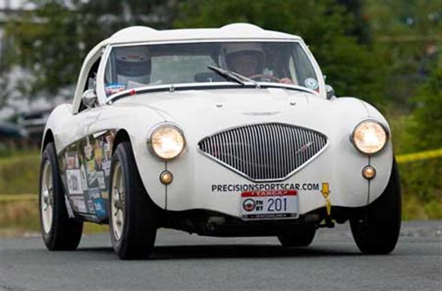

BTW compare this photo from Targa 2008 to the one in the previous post from Targa 2007 and notice the difference in my helmet.
Last year I wore my closed-face race helmet--in order to view the route book I had to hold it up in front of me and it was like reading while being on a roller coaster wearing a dive mask. This year I wore an open-faced model and I actually got to see some of the scenery!

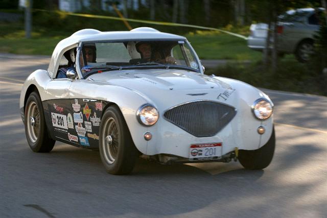

No this is NOT the super-rare Abarth Zagato Healey, simply a period hardtop onto which Michael grafted two halves of a fiberglass easter egg to provide head room.
