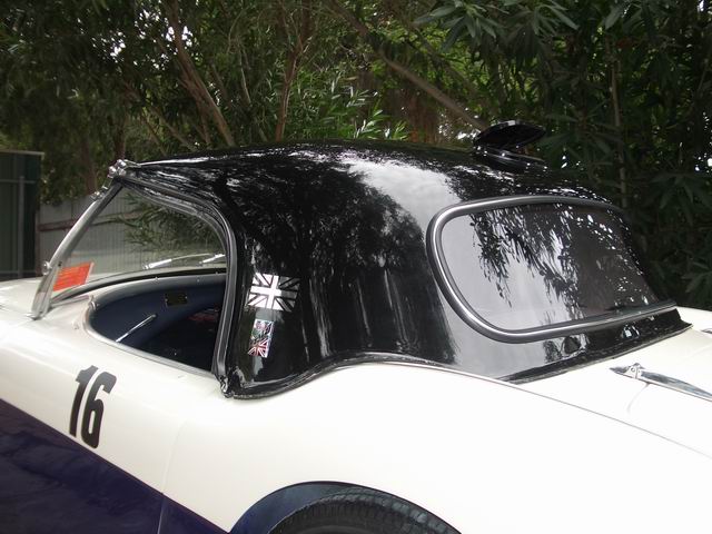

A couple of years ago, Michael Oritt & I got tops from Nick Freeman - UK. Very nice tops. Required some hand fitting & trimming/installing the rear screen. The supplied sidescreens, didn't fit well & Nick was not much help. I did some radical bending of the aluminum frames, etc & got a pretty good fit.
I think maybe David Ward of "Big Healey" UK sells very similar tops, maybe with less hassle?
I've got lots of pics that I could email to you. One is attached. What measurments do you want?
D

Thanks Dave Russell, I am thinking of getting my coachbuilder to make one for me in aluminium, if I take it further I will be needing a few pics/measurements. Were there ever any genuine hardtops made, or were all after market productions created by various companies to various design?

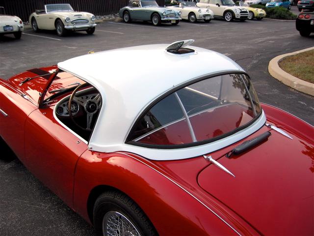

Dave is a master of understatement--"lots" is more like it though that should not have been a surprise given the ideosynchratic nature of BN1's/2's.
I installed the rear stays both for esthetic reasons as well as to make the top more rigid prior to fitting the rear window--Freeman's top is very light and deforms easily with the pushing effort necessary to fit the windows into the seal.
I have seen pictures of one aluminum hardtop made for a 100 at some time and place unknown. Like the early FG tops made by aftermarket suppliers the window opening followed the line of the soft top and was, to my eye, butt-ugly. The design that Freeman came up with is an adaptation of the factory 6-cylinder tops shortened appropriately, but has a much more pleasing appearance with a wrap-around rear window.
I'm attaching one photo of the top taken from the rear showing the window and stays.

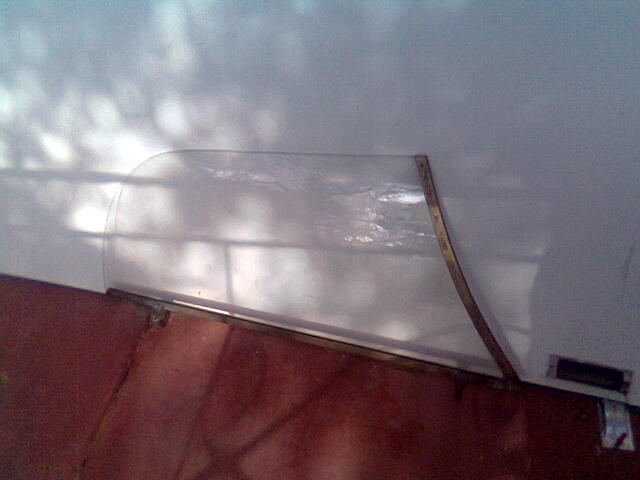

It is only my opinion. I had one piece Perspex side screens once. They are hard/impossible to keep sealed to the top, especially at any speed, are a royal nuisance to open or close, like roll up windows that won't roll down, & have a down sweep rear contour at the back that makes for very little head clearance when entering or exiting, Unless uou have an extra short neck. They work even less well than the original BN1, BN2, plexiglass/canvas affairs, which can at least be opened. If you put the solid plexi screens on a hardtop, you will almost certainly need to install some kind of external door latches to get the doors open.
The later aluminum framed sliding side screens are better in all respects. I would have the window openings in the new top contoured to match the later screens which have a higher rear corner, & use later aluminum framed screens.

Yes - exactly. I really wish you could drive the car for a while with these screens on before making a final decision. It's hard to describe how awkward it can be to have fixed side windows. My BN2 came with the older fixed screens for some reason, PO preference? I agree that the canvas - Plexi original screens were butt ugly. I had a couple of years experience with them. There is a reason that the factory went with sliding sidescreens on later cars.
How are you planning to access the inside only door latches. On the softtop it could be unsnapped & a hand reached in to move the latch. Not so with a hardtop.

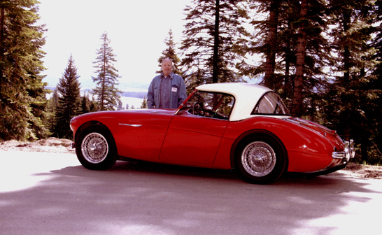

Thanks healey 100 s,
Yours is the second pic of that type i've seen, how is the vis rearwards?, it appears to use the original front screen latch, does it use the rear shroud cleats also? might have to have you cover with glad wrap and cover with plumbers foam so as to make a mold that my metalman can make a last from!.
Look out, the dockers are coming to get you!
Hi,
Excellent vision and yes, is uses the latches and rear shroud teardrops . Whats your email address ( if its ok to disclose on this forum)- I have 20 odd photos you can view. Ive sent you a pm
