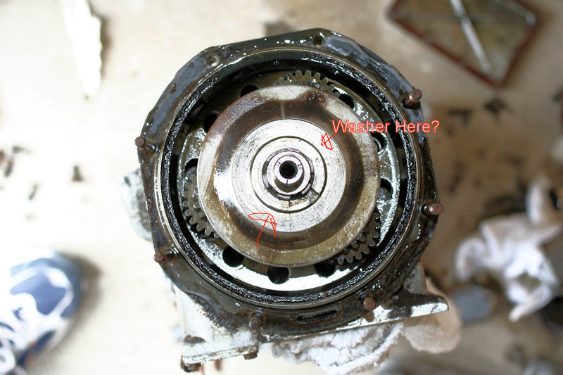

I was inspecting the new to me blue lable od unit and while the gears look good pulling the screen I was greeted with what ever is pictured below. I got a good deal on the od tranny and I figured it might need a rebuilding but now that I know that it does what are my options?

Ah, thought that was where it came from....looks like the circlip (#50 in Moss catalog) or, hopefully the relief valve plug washer (#74).....either are easy to correct - especially #74.

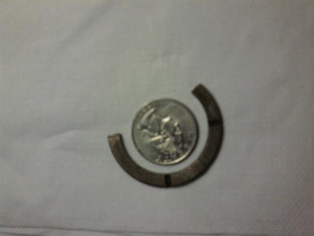

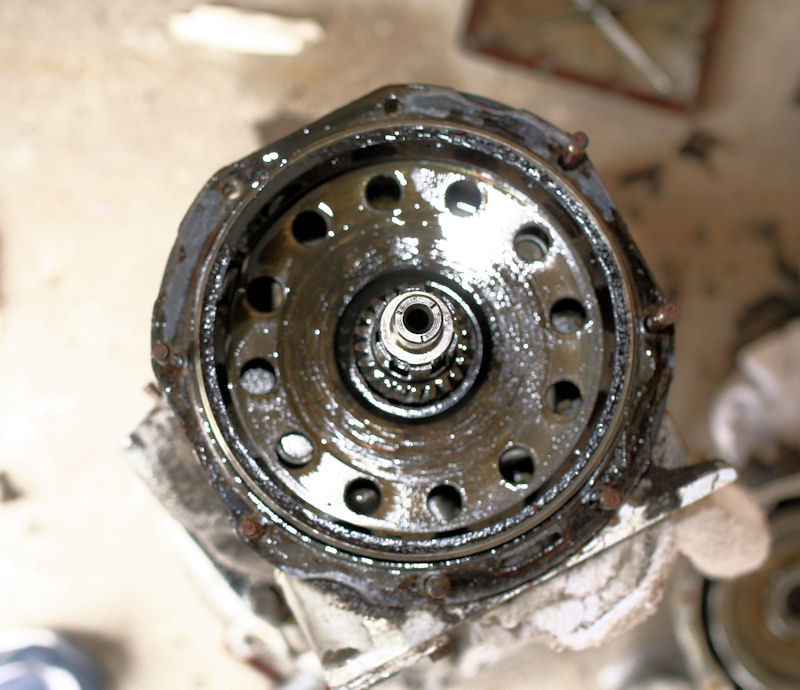

Well I dug in a bit and now have 3/4ths of the ring I think more came out when I pulled the rear casing but I have yet to find them. The planetary gears look quite good and the rest is clean so maybe it's #13 on the diagram? The ring looks to between a silver dollar and 50c piece size wise.
Yep, bet that's it...you can get it by itself or get the whole assembly (#9)...looking at an OD I've got standing in my garage, looks like if you remove the rear half of the cover, you're right at it.....sliding member #4 is the front half of the "clutch" assembly, #16, the annulus is the other half....when you pull #4 out of # 16, you'll see the entire area where we're talking about,

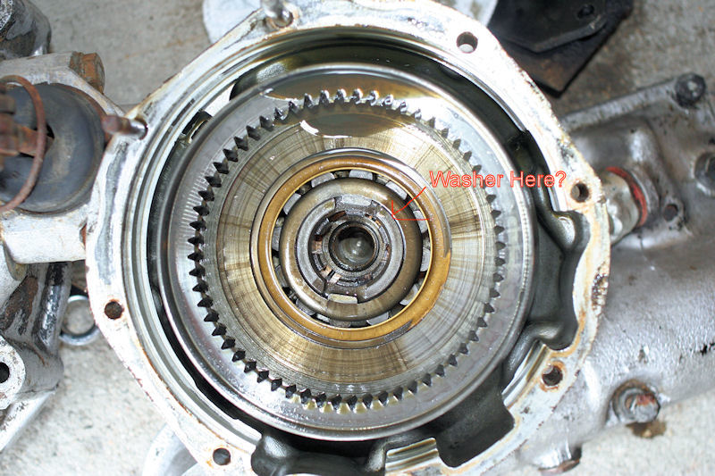

Well, just saw you have #'s 4 & 16 apart....its on he mainshaft behind #12
Here I believe:
