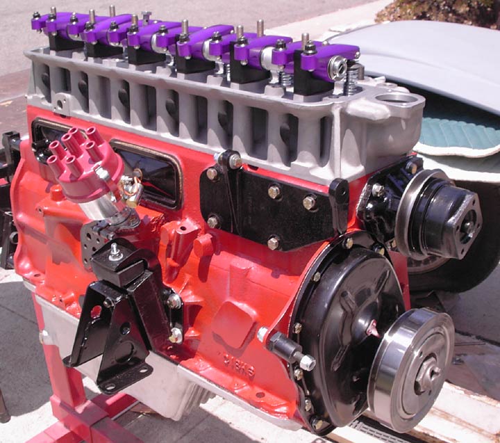

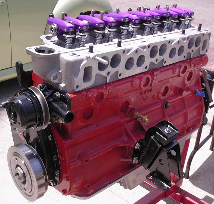

Hi Daily,
Here are a couple shots of my 29K engine for reference. From a late BJ8.
yo greg,
thanks, mystery solved, my block appears as yours sans your tasty upgrades.
with respect 59er
According to Clausager, the revised dipstick location and longer dipstck was incorporated beginning November 1993, 29K/279 onward.
