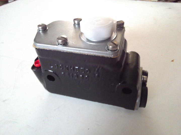

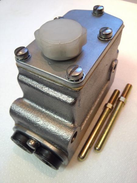

I suggest you consider having your original sleeved and having the bore resized to 3/4" if you have disc brakes. This is the correct bore size for a disc brake conversion. Your brake pedal effort will be reduced by 33% and you clutch action will also noticeably improve. This is a much better solution to buying an aftermarket one and will outlast a reproduction unit tenfold - you will never have pitting problems again.
This is a service I have been offering for over 10 years with excellent results. You can contact me directly if this interests you and want more details. A couple sample restored units pictured.
