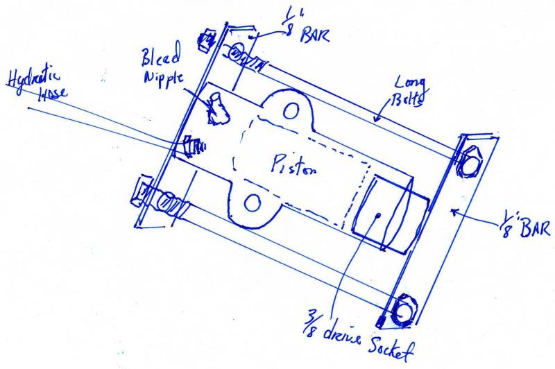

Here's my method for bleeding the clutch. My drawing isn't very good but I hope I can get the principal across. I unbolt the slave cylinder from the bell housing and let it hang on its hose. I cut 2, 1/8th inch steel bars about 4 inches long and drilled holes in them for long bolts. Take the pushrod and rubber boot off the end of the slave and insert a 3/8" socket of the appropriate length into the bore of the cylinder. Choose the correct length socket that will position the piston in its at rest position, which will be found by inspecting the length of the pushrod and its required position relative to the clutch fork. Use the 1/8th inch steel bars and long bolts to clamp the socket into the bore against the face of the piston. Now with the slave held in hand and bleeder screw accessible, bleed by the pump and hold method. Works a treat.
Another point is that I don't believe the gravity drain/bleed method on the Big Healey clutch slave cylinder will work because the clutch line goes up across the fire wall before it goes down to the slave.
