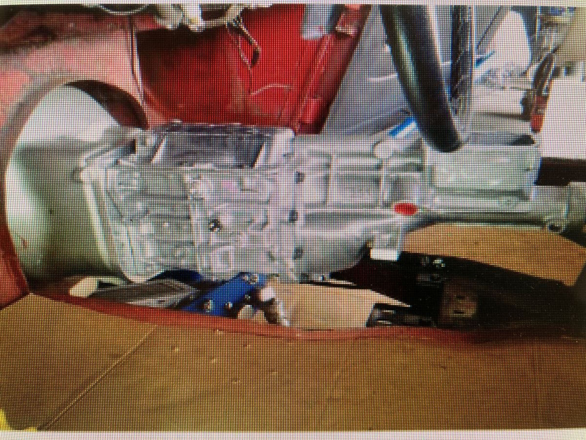

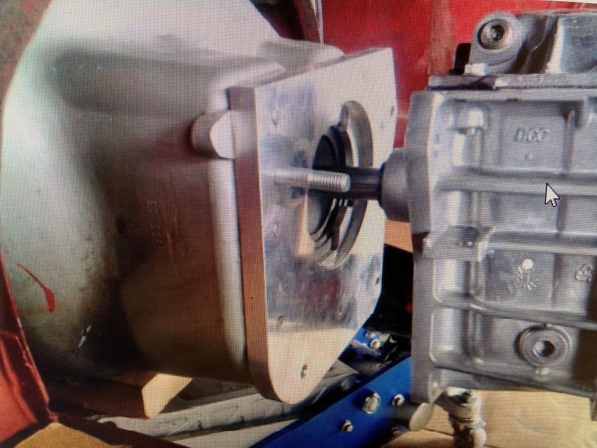

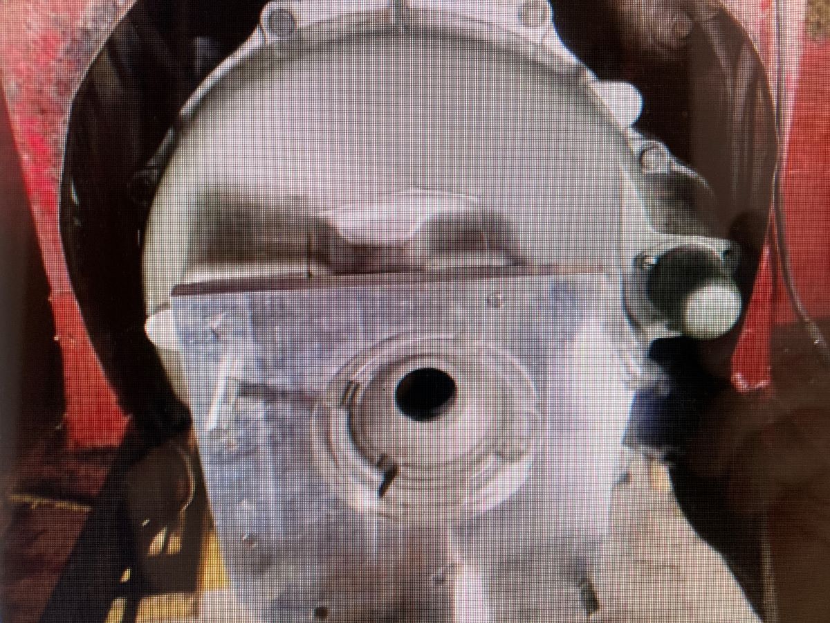

Please see the included images from the article. And, maybe, someone might know the source of the article?
