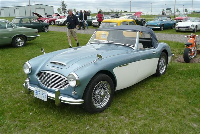

I have Fuzion HR1 185/65R 15 on my BT7 and love them and they where cheap.
Cheers
Mark
