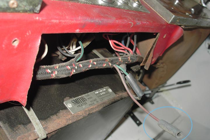

Hi Bob,
Originally the radios were connected to a brown wire which is "always hot".
