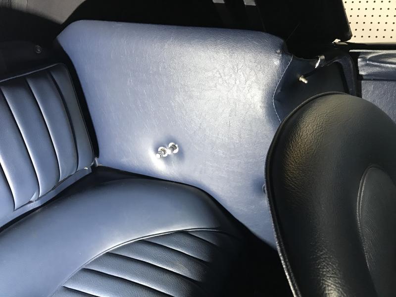

The rear side panels did have the large embossing. The seat backrest was pleated. The piping was matched to the seat covers color.
Are you sure with the leather interior, the side panels have embossing? Can you please direct me to a link or something that clarifies that.
My leather interior is from Heritage. Heritage is known for quality kits and being accurate. My rear side panels are not embossed.

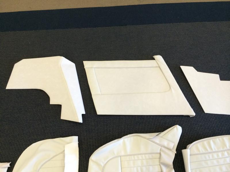

Here's a photo from sports and classics.com, their leather kit shows non embossed side panels.

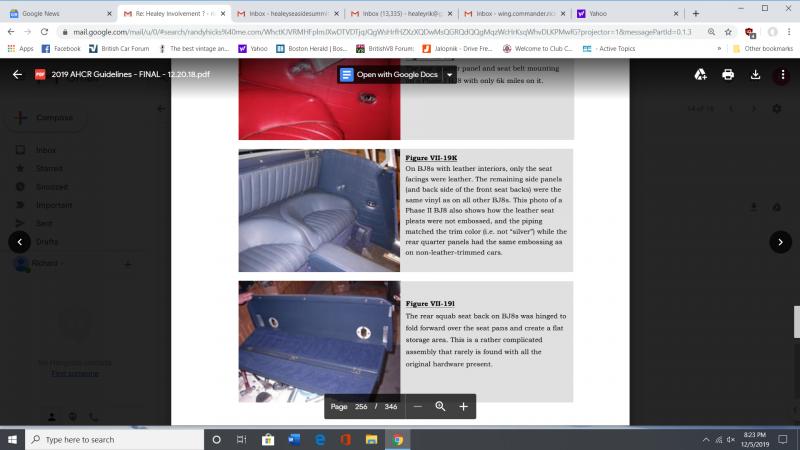

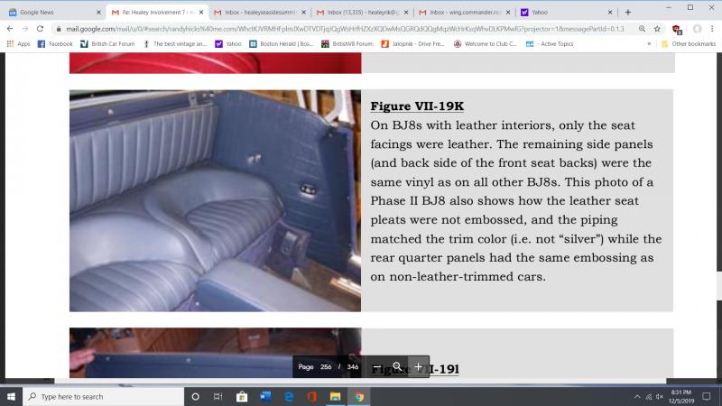

The Concours Guidelines from the Austin-Healey Concours Registry is a living document. It changes over time as new evidence comes to light or things need to be clarified. That's why they are amended over the years and the 2019 version will have much more info than the 2006 one, including pictures. That's where the photo and info come from. Not available online, but see here where the guidelines can be purchased: https://www.britishcarforum.com/bcf/showthread.php?115525-PSA-from-the-Concours-Committee

Someone did notify Heritage, several years ago. I got a call from the honcho at Heritage (forgot his name) who was making the new leather kit for Patrick67BJ8. He argued with me that the rear side panels of leather upholstery should not be embossed like the vinyl ones because it didn't "look right" without the squares on the seat back. In response to a previous query from Fourintune about the configuration of leather interiors, I had contacted all of the BJ8 owners whose cars were recorded in the BJ8 Registry as having original leather ("hide") upholstery. Only four of them still had the original leather. They confirmed that the original side panels were vinyl and had the embossed squares. I told that to Mr. Heritage, but he insisted that he was a Brit and an expert on Jaguars and had been making Healey interiors forever and knew what he was talking about. Apparently, he didn't change his opinion based on facts about what was original.
I sent him pages from the factory parts book showing the pieces with their respective part numbers. The rear side panels have the same part number for the vinyl interiors as the leather interiors do. “Tony” is the owner of Heritage.
