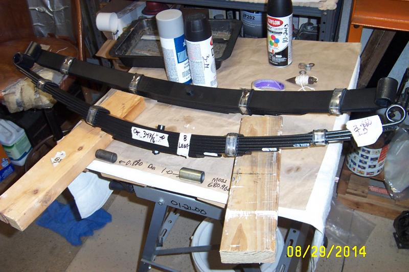

Please ref photo.
Upon starting reassembly on early 1964 BJ8 P2 found an issue with the rear springs.
Background, car was disassembled over 20 years ago and in storage until recently. No known history before we bought it so quite possible the rear springs are not original, but car does have low miles (~50k). The car was an export car to Germany and the Vin is HDJ8-28207.
We ordered Moss number 680-960 which is the front bushing for all Healey springs per their catalog. Problem is the bushing OD is .995" and my spring eyelet ID is approx .880" which is same relative dia of the old bushing that was removed. The springs are 34-7/8" center to center of the eyelets. Both eyelets are of the same ID of the .880" The springs are 8 leaf.
Per Moss technical staff the later BJ8 springs that they sell (021-583) have a front eyelet ID of approx 1{" to accommodate bushing 680-960). But the rear eyelet of the later springs has approx ID of .880 which is identical to my old front bushing. A new set of poly bushings fit perfectly in either of my eyelets and would fit into the rear eye of the new spring. Supposedly these springs are 5 leaf and 32-1/2" eyelet to eyelet.
The earlier Moss Springs they sell (021-582 pre phase 2) have both front and back eyelets the same aprox 1" dia and both take the bushing 680-690. Center to center of eyelets is supposed to be 34-7/8. Same as mine, but they are 7 leaf.
SO what springs do I have? Old photos show the car years ago with a good ride height. I would like to find a correct set of bushing for the front eyelet so can reuse the springs. We do not want to use the old bushings.
Thanks to Moss Technical staff as we crossed an MGA front bushing (267-510) that has almost identical dimensions to my old bushing. But we certainly do not have MGA springs as they are over 40" eye to eye.
Can anyone shed some light on these mystery springs that we have. I suppose we will order the MGA bushings unless some one says no way we should use the current springs we have.
