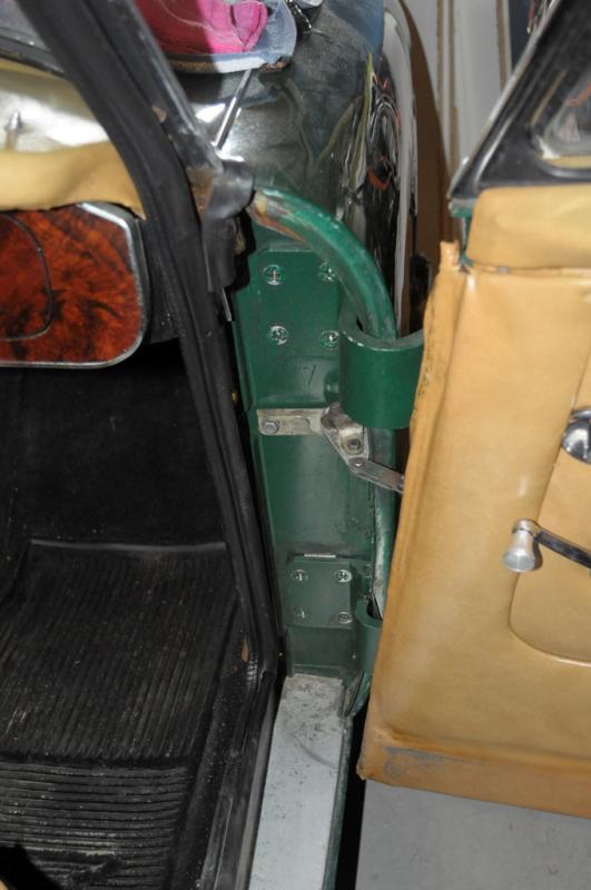

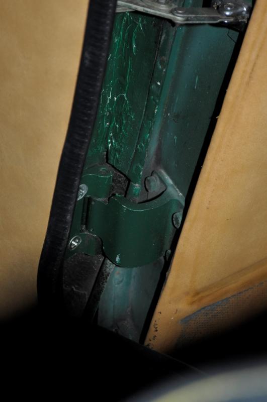

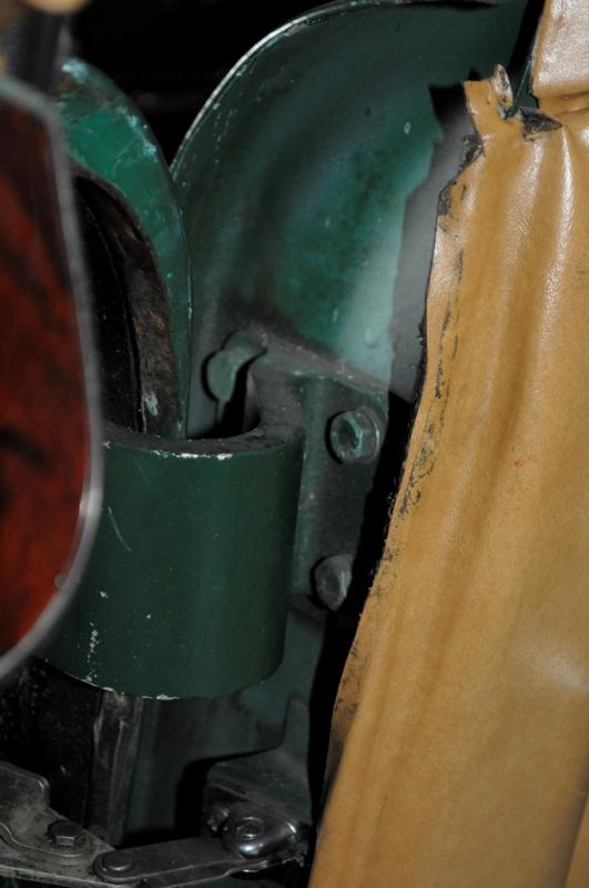

Hope this helps
Regards, Hans

BJ8 Phase 1 hinges had "fingers". Phase 2 hinges (both upper and lower) were rectangular, without "fingers". I've seen a few Phase 2 BJ8s recently that had the Phase 1 hinges and thought the doors had been replaced. But then I found that AHead4Healeys only shows the Phase 1 hinges in their catalog. Maybe that style is all that is available new now.
