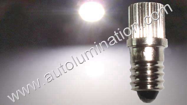

If your car is negative, get an E10 one watt forward firing led light bulb. Bright white, 5000-6000K
I'm using the E10 Superstar with heatsink super white Led Bulbs. Photo below. I got them from this site:
