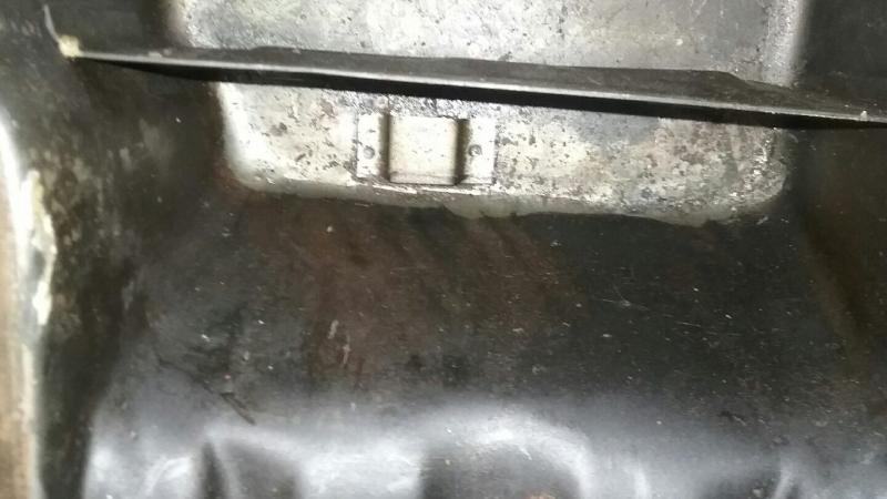

The broken piece is likely in the bottom of the sump, where the pump pickup screen is; how is the crankshaft going to hit it? I wouldn't feel comfortable with it in the pan, but if the car needs to be driven a few miles to a shop with a lift I think he'll be OK.
Edit: In fact, the piece is probably near the strange tab in the pan, which some have suggested is a stop for the dipstick:
