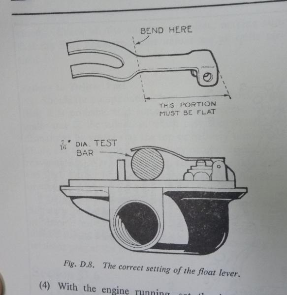

From section D.8 of factory manual:
attachment.php
Reassembled all parts using new gaskets. Set the level of lever at about 1/2'. The carb has a Grose type float valve. Started up and no leaks. Car stalled and then the fuel pump started to pump constantly and fuel flowed out overflow tube. Restarted engine and it still flows out overflow tube. Put a small hose on the tube to capture fuel rather than just dump onto the ground. Where to go from here?
