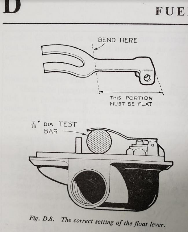

Lastly, check that the small metal fork-like lever arm has the right curvature- it may be part of you issue. The shop manual specifies a clearance value and has a picture of what the curvature should look like. Use a drill bit of the specified diameter to check the clearance.

For adjustment, make sure only the "tines" of the fork get bent. If the entire fork bends upward from the pivot point, the needle can fall down too far and get hung up at an angle in the jet bore, causing overflowing.
See Joe Curto's video: https://joecurto.com/su-float-bowl-covers
Note that if your float levers look somewhat different than those above, the flat part of the arm must still be flat as shown. Somewhere in HD8 production, they changed the style of float lever and the height (when upside down) of the pin on the lid to match.
Curto discusses the different float covers with their levers in his video linked above.

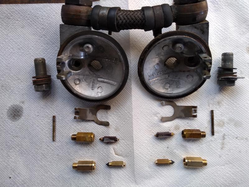

Hi All and thanks for your help
I fitted the AH Spares provided needles and valves,they are vitron tipped and all seems to be well with no leaks.
I checked the measurement with a 7/16th drill bit and it seemed pretty close so I left well alone.
As you can see I removed both tops together with the cross feed,but then realised there was not enough room to refit without separating them.
the worst job was removing the big brass banjo nuts when it was all off the car.
Anyway all went well in the end , lets hope it all stays leak free.
