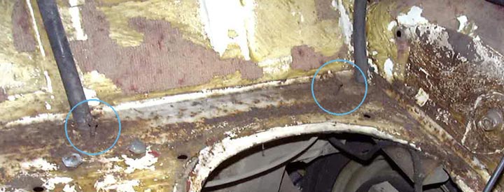

Well she just might: Look at the very back and on the bottom is a wooden piece covered with vinyl.
Installed in this piece are three slotted flat head screws that thread into the car body and can be rusted up tight.--Fwiw--Keoke-

Here is a picture of two of those screws. The third is by the other arch.

The three screws have blind nuts welded to the body. If you are lucky you won't damage the nuts getting the screws out. Use plenty of penetrating fluid and give it a couple of days to work. Have a good day!
