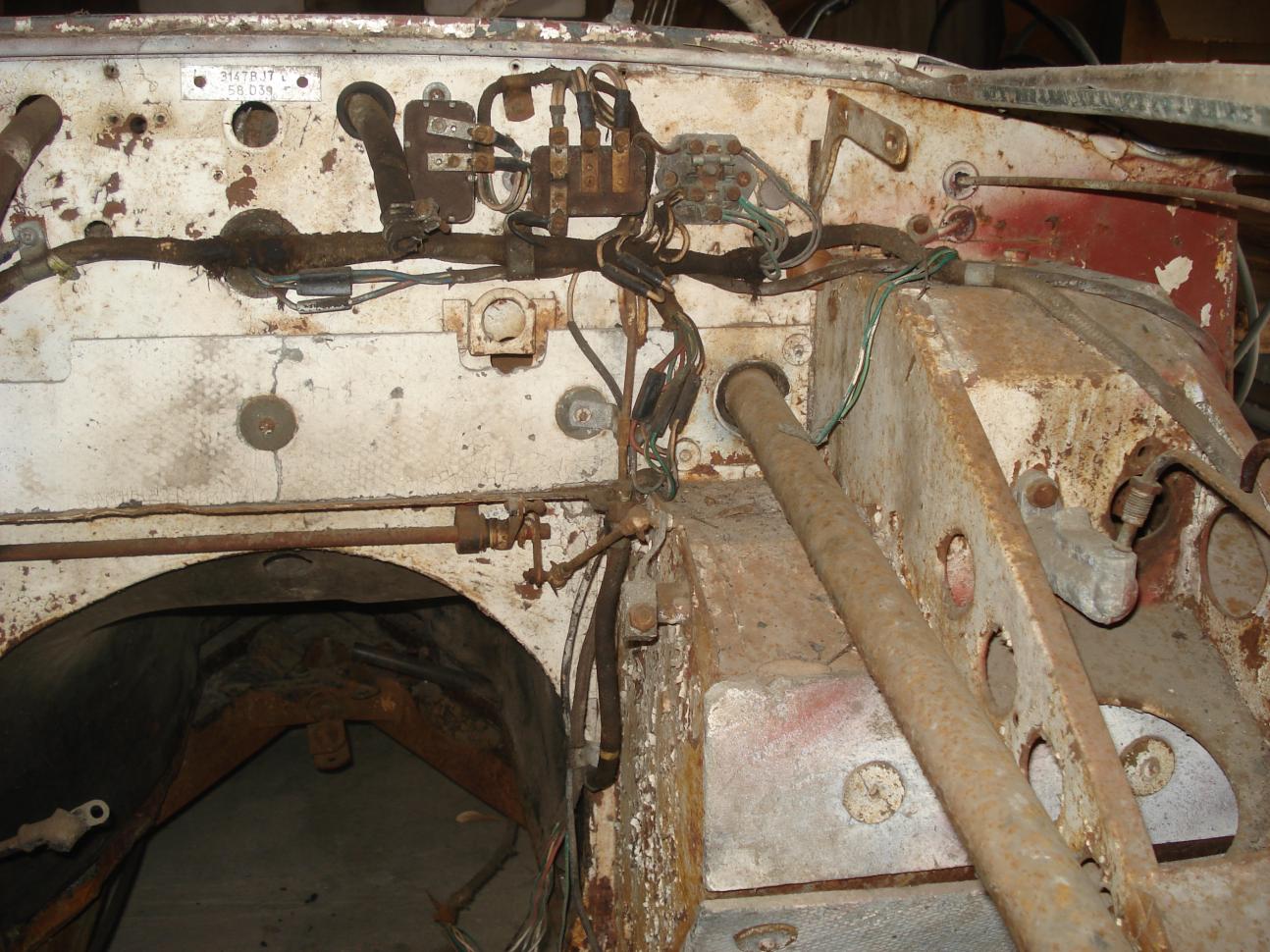

I'm putting the new wiring harness in my BJ7. Things are rolling along smoothly until I come to wiring the fuse unit. I've checked the wiring diagram in two different publications and both agree that fuse unit terminal #2 should have a single Purple wire attached to it. Problem is, my wiring harness has no exposed Purple wires anywhere near the fuse unit let alone terminal #2! There are two Brown with Green tracer wires that are in just the right location and the right length to attach to terminal #2. I also have a photograph of a friend's BJ7 that appears to have these two Brown/Green wires attached to this location, but the photo is just a little blurry when I zoom in that far. Would one of you kind BJ7 owners please check to see what color wire(s) are attached to this terminal? Thanks, Griz
