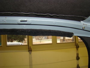

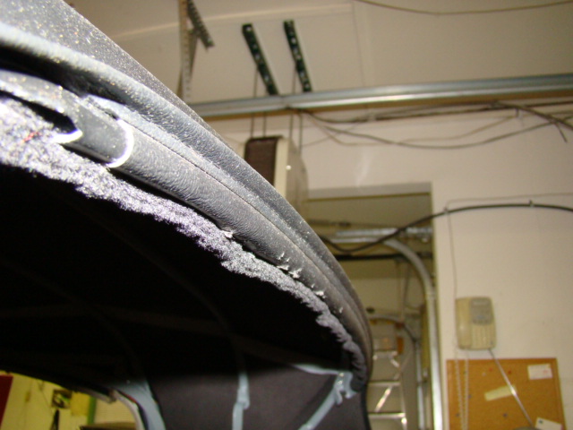

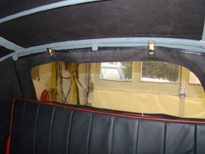

Hello Robert. I am very familiar with installing the BJ7 original top. If done properly it's as functional as the zipper type. The extra material is folded over the "semi-circle" tube and then clipped in place. Over the inner lip of the semi-circle goes a cut-to-length U-shaped black fur-flex material similar to what goes around the lower dash area. This is important as it protects the top fabric from abrasion when folded down. Far to many AH forget this item. I'll try and get some photos today.
I must note that the PO used a zipper window. Also, the sides get tucked down inside the chrome surround strip. You'll have to reattach the lower bar that gets screwed to the shroud a couple times to assure the sides of the top are flat and not wrinkled.

Robert, here's some photos of the BJ7 top I installed with the toggle switches. Note the furflex strip along the rail that's attached to the top bow. Also note the "flap" of material is folded around the U-shaped metal bar that's attached to the top bow.

Robert, here's a couple more photos.
Note again the furflex strip.

Bob, you need the flat secured to the 3rd bow to keep the top from "billowing" up in the air, and also to secure the rear window. Once mounted on the bow the metal U shaped bottom of the bar goes to the front. The flap goes around the bar and is secured by U clips (same as on the seat type) then place the furflex over the U shaped bottom. The furflex protects the rear window when the top is lowered, plus gives a more finished look. Check the photos I listed in the other post.
