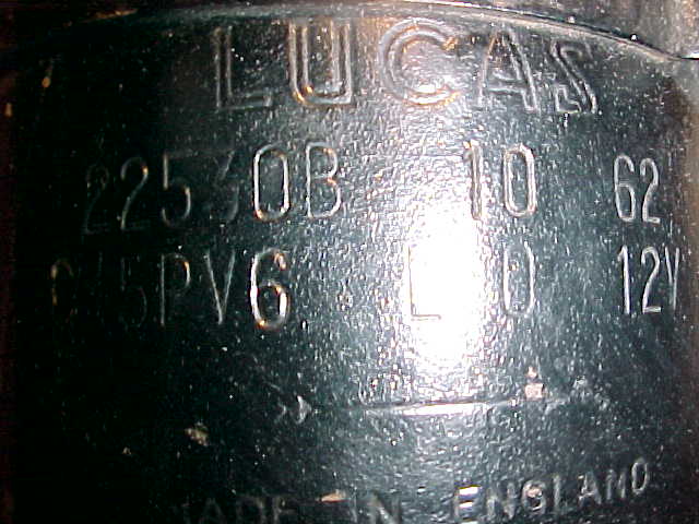

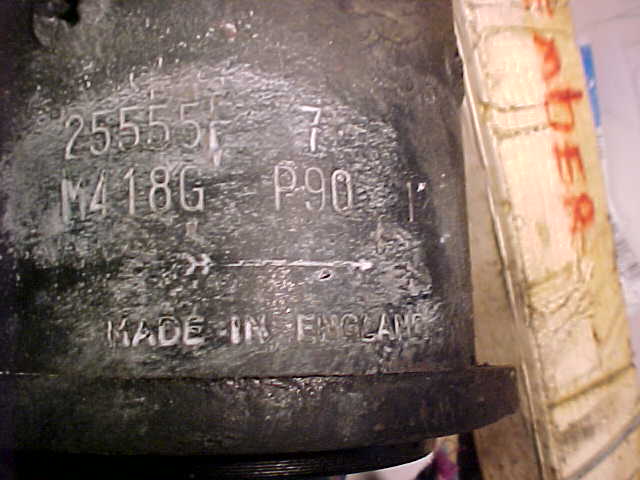

Well Scott that certainly does help, also it coincides with Moss catalog numbers. So, If I understand correctly, they should be date stamped.
I hate to beat a dead horse here, but now maybe someone can explain what Lucas means when they say model M418G starter "Eclipse Drive", "S Drive" and "Roller Clutch Drive"? It's not that important, but interesting. All this valuable information was found in the Lucas Service British Car replacement Parts 1965-1976. It's interesting in that it shows all the Lucas parts for a given automobile.
