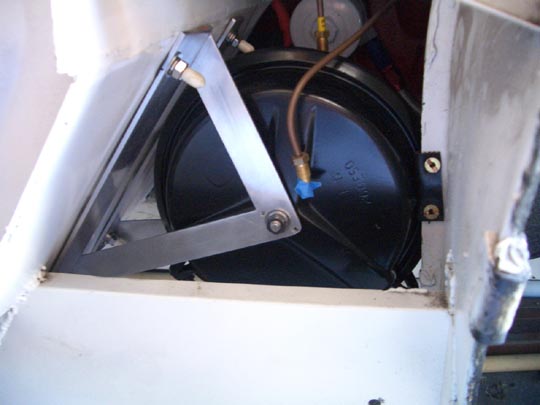

Finally got my reconditioned brake servo back for my BJ7, i know it mounts on the footwell but exactly where ?
Anyone got a picture, I did take one of my servo but havn't a clue how to upload it.
Hi Chicken, On the sloping part of the foot well you will find Four studs. The mounting brackets are secured to these studs. The original style booster is bolted to the brackets with the large canister facing the engine and the brake lines can then be connected. Hope someone has a piccy for you--- /bcforum/images/%%GRAEMLIN_URL%%/cheers.gif--Keoke
